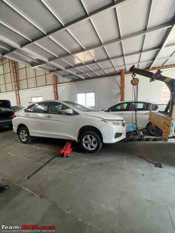

Hi Everyone
I have deduced to get my Honda City CVT repaired at Sehmbi, Bangalore. They have emailed me the estimate and a timeframe of 15 days to repair the automatic gearbox. I will update here about my experience, after I get the delivery post repair. Hope it helps other BHP members who need their gearboxes repaired.
Here are some pictures when I dropped the vehicle at the Sehmbi workshop.

Originally Posted by Ketav (Post 5496016)
Hi Everyone
Attachment 2419068
Attachment 2419069
Fingers crossed for perfect repair job. Being a 5th gen City CVT owner, this is really concerning :Frustrati.
Please keep the thread updated with the FNG's findings on the cause of the failure, and the resolution. Best wishes.
