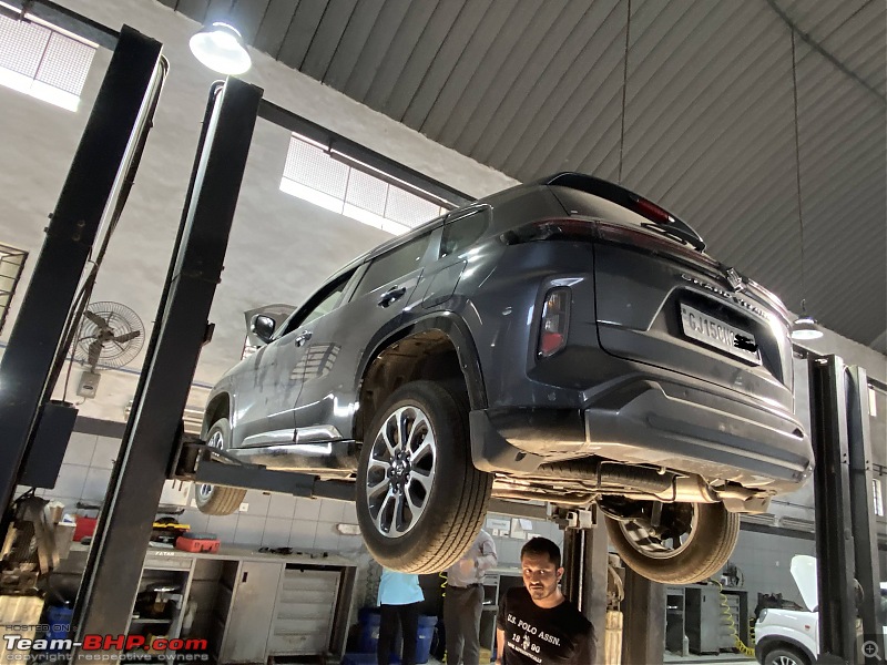

This post is on behalf of my uncle who picked up a Maruti Suzuki Grand Vitara Intelligent Electric Hybrid Zeta+ (Strong Hybrid) 1.5 CVT in the Grandeur Grey colour on 08th February, 2023 from Kataria Automobiles Pvt. Ltd, Nexa Kataria, Vapi. The purpose behind buying this vehicle was to save on travelling costs owing to my frequent travels for my business. The car was butter smooth and I was very happy about the fuel efficiency it delivered since I switched from a 2018 Toyota Innova 2.8 G which guzzled up a lot of fuel.
Cataclysmic Engine Failure of my 15-day old Maruti-Suzuki Grand Vitara (Strong Hybrid)-img_0504.jpeg
It was on 23nd of February, while I was driving around 01:00 am at midnight that I could hear some strange noise from the engine bay. I immediately pulled over to the side and checked for any unusual thing happening at the engine bay. There was a mild noise being observed which was coming out straight from the engine. Next morning, I immediately took my car to Kataria Automobiles Service Center, Vapi to get my car inspected. They acknowledged that there was some sort of noise coming from the engine and they prepared a job card and took the car for inspection. The next day I again visited the Service Center and to my shock and surprise, the noise was no longer mild, but I was very loud like a tractor. It was a clear indication that there is something seriously wrong with the engine. We had talks with the management and they gave me a test drive Ignis manual as a courtesy car. At the time of preparation of the Job Card, the odometer reading was 3817kms. The Service Advisiors did not have any idea what to do since they were completely unaware of the Hybrid technology stashed with this particular vehicle and it was very difficult for them to diagnose the issue. They alleged that MSIL engineers were on call and they tried to remotely inspect the car but even they were unable to diagnose the issue.
1st March:
I again visited the service center as there was no official intimation as to what issue my car was facing and how did they plan to resolve it. It had been almost 7 days without my brand new car, and the amount of stress I was going through was immense. I could not undertake my business travels because the courtesy car they provided was very small, unsafe and I was scared to travel with it on highways. Apart from that, I was facing huge business losses and upon that, I was also supposed to pay the EMI’s of a brand new car that was sitting at the service centre.
When I visited the service centre on 01/03/23, to my shock and surprise, the service centre had removed the oil pan of my car without my permission and there were visible damages. It also seems that they tried to disassemble the engine and remove parts without my permission. I wanted to take a video of the sound coming from the engine, but the Regional Manager was reluctant on allowing that and moreover, when we asked them to seal the oil pan again, fill in oil and start the car, they refused to do so.

The Service Center is now offering me to change the complete engine assembly.

I kindly requests bhpians and senior members to advise me on this issue. My car is sitting at the service center, I am facing business losses and I have a loan to repay for this car. It is quite pathetic that a fifteen days old car has to go through this. I am evaluating my options to go legal on MSIL. Also, Maruti Suzuki if you're reading this which eventually you will, I am coming for you!
UPDATE: 4th March, 2023:
They have not replied to my E-mail and they have no instruction from MSIL. They said they will let me know on 4th March, 2023. Am i being scammed? What exactly is MSIL upto?
