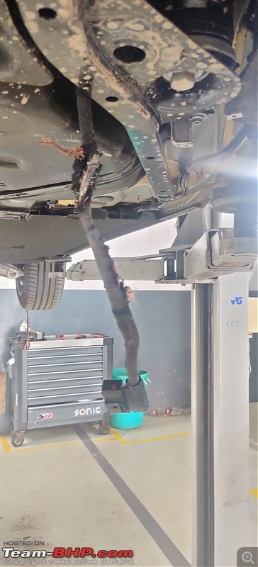

UPDATE
So we got the report from the Audi Service Centre and unfortunately the issue has been created due to rats eating on the harness that has connections to the fuel pump and ECM. There is also an ECM error showing. The estimate given is around 8 lakhs. This damage is not covered under warranty but can be claimed under insurance which the obvious way to go.
I have however been told that I can receive the car with in a week if the harness is available in India else it can take more than a month if it needs to be imported. My fingers and toes are crossed now.
Here is a photo of the damage.
