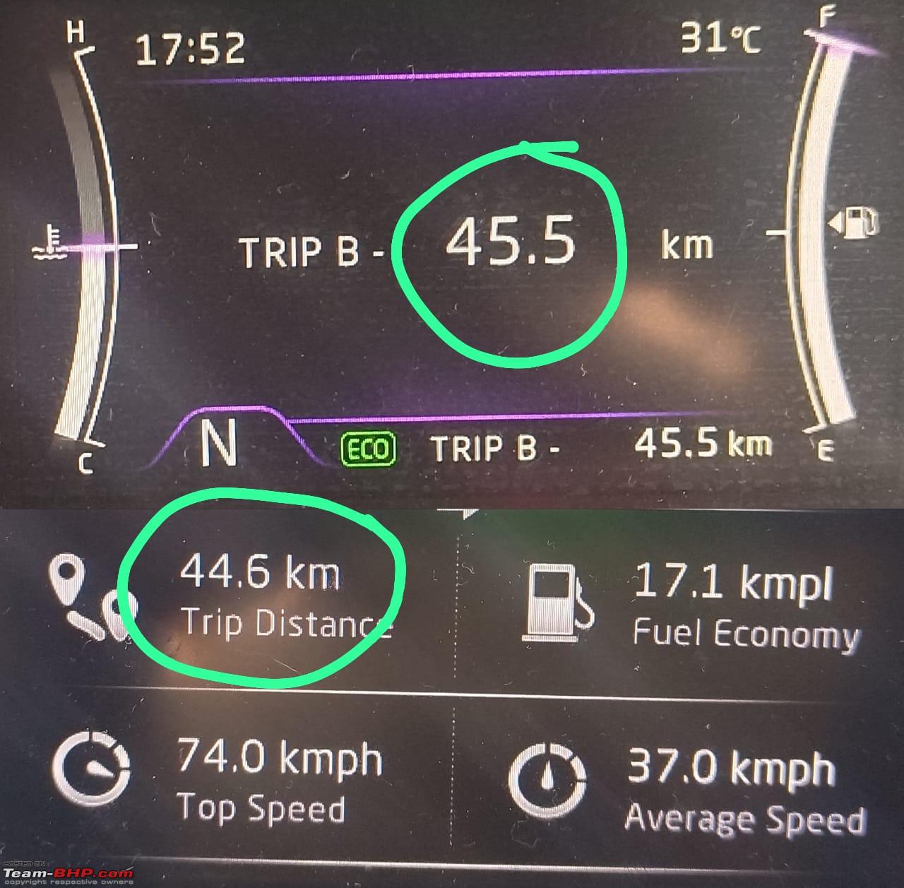

I drive a Marazzo M8 and I reset my trip meter to zero on the first of every month. The Marazzo's Driver Information Display shows intervals of 25 km from the start of the drive, such as 25 km, 50 km, 75 km, and so on.
The Ecosense app in the ICE also displays the distance travelled and fuel efficiency (FE), among other things. I have noticed a difference in the distance travelled displayed on the MID (Multi-Information Display) and the Ecosense app.
The upper part shows the MID trip B reset to zero, while the lower part displays the Ecosense reading at the same time.
Distance to Empty (DTE): How exactly is it calculated?-7108290d4f2d47f09f4b74de1d35dd3b.jpg
The upper part shows the MID reading at the end of the trip, while the lower part displays the Ecosense reading.
Distance to Empty (DTE): How exactly is it calculated?-400d4c125a674a2484c4f20c60b5e5bf.jpg
From the pictures, it is evident that there is a disparity of 900 meters. The Ecosense app shows an approximate difference of 1 km in a 45 km drive.
I have driven approximately 118,000 km, so there is approximately a 2,400 km difference between the odometer reading and the Ecosense reading.

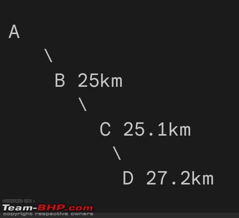

Regarding the second issue, the distance from my home to the office is approximately 27.2 km, according to the MID. There is a display on the MID that appears after completing 25 km. I am aware of this point, as it is only 2.2 km away from my destination, which is also confirmed by Google Maps. However, after changing to new tires, I noticed that the 25 km mark on the MID has shifted approximately 100 meters towards the destination, resulting in a slightly shorter distance. This difference is also confirmed by Google Maps.
A is home
B is previous 25 km mark
C is new 25 km mark
D is Hospital parking slot
Distance to Empty (DTE): How exactly is it calculated?-530bbd3a061643258b2b3e1920a79c1c.jpg
My doubts are
Why there is a differance in MID and ecosense reading?
How the distance is reduced after tire change?
