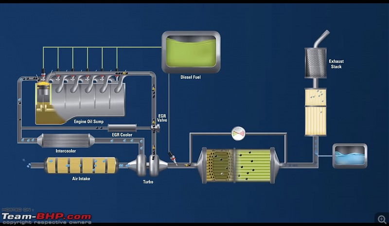

Originally Posted by AirbusCapt View Post
this will cause dilution of engine oil by diesel. See the problem with bs6 and dpf is that the car needs long journeys to allow the exhaust temperaturehot enough to burn the soot
True.
on short journeys and when the optimum temperature is not reached, the unburnt fuel is collected in the exhaust end and in the next start cycle, it mixes with the engine oil leading to its dilution.
I searched as to how DPF works and nowhere I could find any source which states that diesel backfires into engine. Even if the fumes and other particles backfire into engine, then the engine oil would wear out sooner.
Oil level almost twice the max mark | Now what?-f99022f88e50437f96d10a1f219db581.jpeg
How and where is diesel or any other liquid going back to engine?
I don’t think diesel should mix with engine oil, won’t it lead to oil oxidising?
Even if we go by this theory that due to short distances DPF isn’t working as intended, then why is DPF warning not on console? Why is active/passive regen not working?
For active regen, there are 2 methods for injecting additional diesel for burning the soot - 1.Post-injection where existing injectors are used to spray diesel in the engine during exhaust stroke 2. Direct downstream injection using a separate 5th injector (doser valve).
The video you have mentioned explains about method 2 and I think this method doesn't cause oil dilution problem.
In method 1 ideal case scenario, all the additional diesel is expected to be vaporised and sent to DPF for regen. But some of the fuel may not vaporize during post injection and stick to the cylinder walls and eventually reach the oil sump.
Modern diesel engines employ multiple workarounds to tackle this issue so this might not be a huge issue in most cases but multiple active regen triggered during a short span of time (due to regen failure/cancellations) could act as a multiplier and cause oil dilution.
DPF warning turns on only if the soot reaches certain threshold and requires a forced regen I believe.
Passive regen works only during long trips and 50KM isn't long enough for this.
Active regen could get cancelled if the conditions aren't ideal (low engine RPM, frequent start-stops, etc)
delusional_fool is offline   (3) Thanks

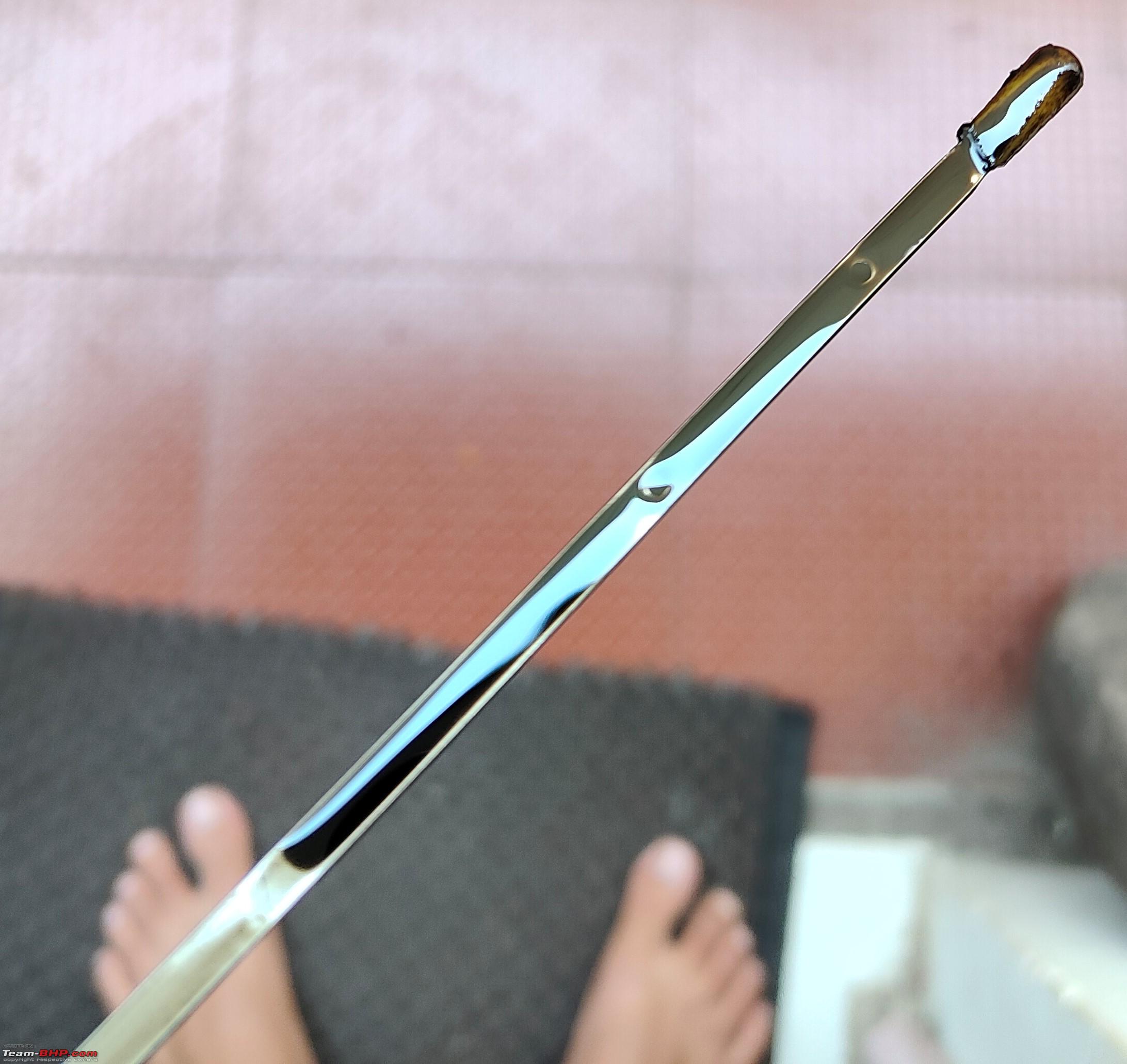

Originally Posted by Sameer016 View Post
This was the oil level before 30k oil change
Attachment 2453139
This was last year at 15k oil change
Attachment 2453138
I'm going to take the Occam's razor approach to this. Are you sure you've checked the reading of the dipstick correctly? After the engine has run for a while, there's going to be plenty of splashing inside, so the dipstick will be wet far above the actual level. Wait for 30 minutes after a drive, during which the oil cools down but still stays warm, pull out the dipstick, wipe it completely clean, carefully reinsert it and then take a reading, drawing the dipstick out carefully. If you have done all this and the readings were accurate, I hope the other suggestions are more helpful to you.
Dipstick oil must be measured when engine is overnight cold. Never on a warm engine. Extract from the landrover manusl.
Probably varies a bit depending on the model, oil type etc. Overnight cold is actually not a good method as the oil volume may be misinterpreted to be lower than in real operating conditions. Hot oil is not good, but warm oil achieves a good balance. This is what I'd read.
