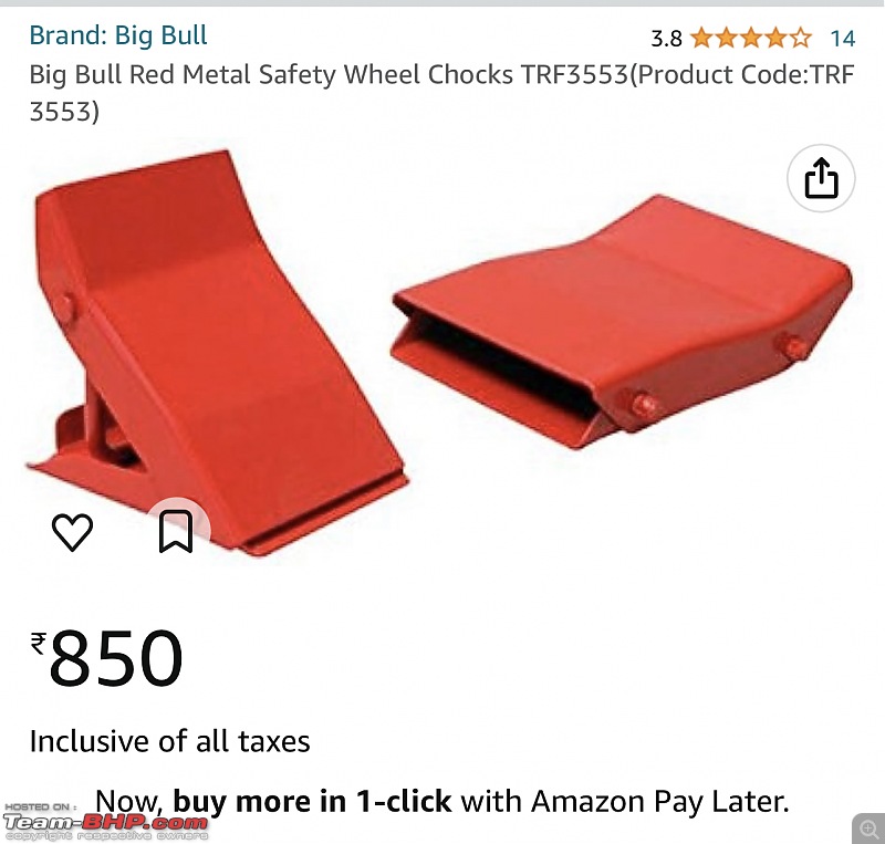

Re: Manual car rolls when parked in gear, normal or not?
and 3. Chocks (bricks, stones etc.) on at least 2 wheels - all applied together.
This is an useful relatively inexpensive product to buy and store in the vehicle(s).
I have a pair of these in each of my Jeepy things.
Available on Amazon.

Since you bring this up:
I am some how not comfortable with engaging the opposite gear. A forward gear engaged, and the car rolls back-ward - or- vice-versa. Fuel injection or not.
In such cases, I try to use a stone to prevent the roll-back. Of course, in a city and where there is a kerb, I turn the steering so that the wheels rest against the kerb, or are close to the kerb.
My fear is that I will forget these things and drive away :(
