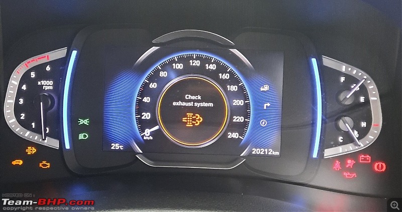

Decided, I shall repeat the same strategy (long drive). But here I drove the car clocking single digit KMS each day for a week. After a week of DPF warning and short drives, took the car to Malshej Ghat. This time I was wrong with my hypothesis. I could not do good speeds on the stretch because of the broken roads. The DPF warning was tirelessly flashing and did not budge at all. When I was just about to reach Malshej ghat my instrument cluster popped a warning Check Exhaust System and also engine check light started blinking.
Hyundai Creta 1.5L Diesel BS6 | 4 encounters & issues with the DPF-check-exhaust-system1.jpg
Called my SA at Sharayu Hyundai, Turbhe and I was told that I can drive the car with such warning (I knew the advice tendered was wrong here) and I did the same. While returning I noticed a weird behavior wrt RPM. The car would not accelerate beyond 3000 RPM in any gear. I could feel the power drop at 2800 RPM. I felt like I was driving a vehicle equipped with a clogged carburetor. The more you tried to accelerate, the more it gave up. So, I drove sedately not to stress the engine and reached Navi Mumbai without any hiccups.

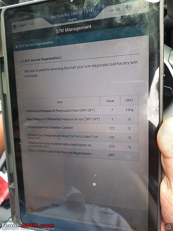

Next day was a Sunday, took the car to Showroom. The head of service advisors was giving excuses to attend the car and was suggesting that I leave my car and collect it the next day. On my insistence and my affirmative stance that I had taken an appointment on previous day, he did budge to assign a SA. Later I came to know that the garage had only 3 scanners out of which 2 were not functional.
Hyundai Creta 1.5L Diesel BS6 | 4 encounters & issues with the DPF-obd-scanner.jpg
Hyundai Creta 1.5L Diesel BS6 | 4 encounters & issues with the DPF-obd-scanner-1.jpg

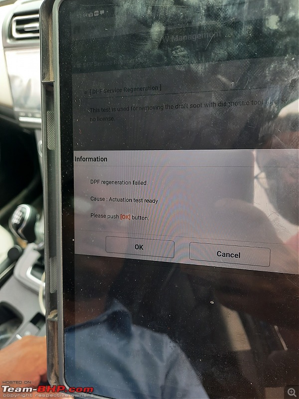

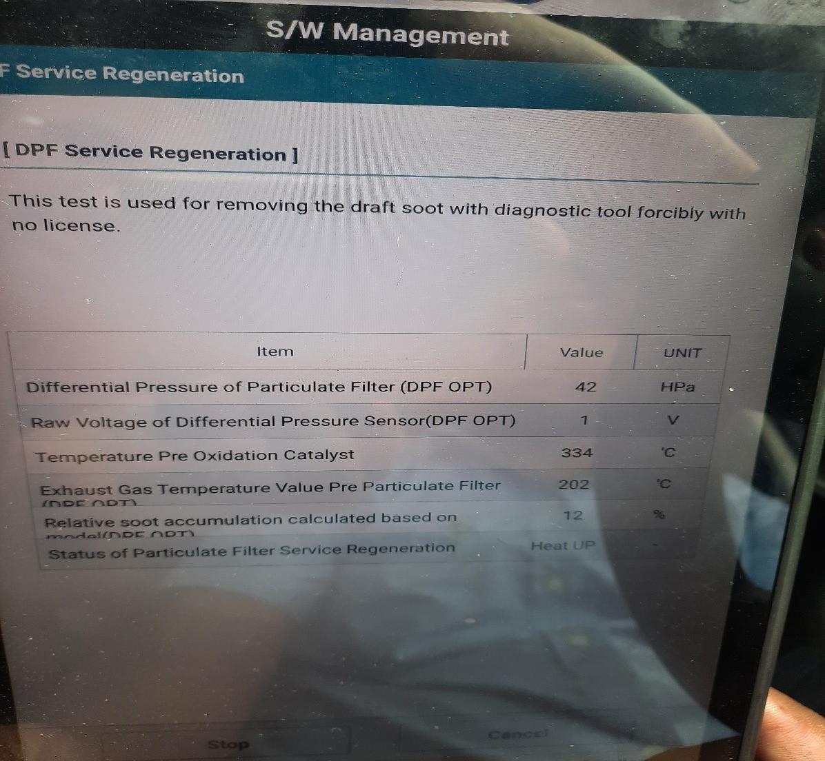

The car was taken for diagnosis. Mr Dharmendra took the car to the open yard and the diagnostic tool was hooked to scan. He had to reset the system to initiate a forced Regen process.
The process was started and it was almost similar to Manual Regen process which I had done earlier. But here the instrument cluster did not show any timer. The tablet indicated few parameters with readings as given in images. As the forced Regen progressed, the exhaust gas temperature increased and reached a max of 635 degree centigrade and the soot load decreased from 200% to 0%. With my limited knowledge I am unable to comment on the parameters. Let the pictures do the talking here.
