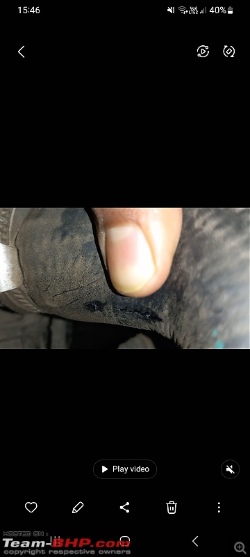

My car has reached the milestone of 44k kms and one fine day I filled fuel and then noticed new air escaping ‘swoosh’ sound between 1500 and 2000 rpm. I thought may be it was due to poor quality fuel and later did a full tank at my usual pump. However the sound kept increasing over the next 2 days and I had used the car for 30 kms. I searched in google and found the hose had a cut . It was small, however I think it would increase if it’s driven further and lead to a breakdown. My vehicle is out of warranty and I plan to take it to an FNG and replace the inter cooler hose.
I have zero trust on Mahindra service centres. For a small issue like this they will take a whole day or two and deliver the car with new problems.

Update on the inter cooler hose . The FNG asked me to get the parts myself from Mahindra dealer/ Mahindra spares parts dealer and get it to the garage for fixing it.
None of the Mahindra spare shops / dealers had it in stock. Hence placed an order and will be delivered in 2 days. Cost is 3961 for a hose.

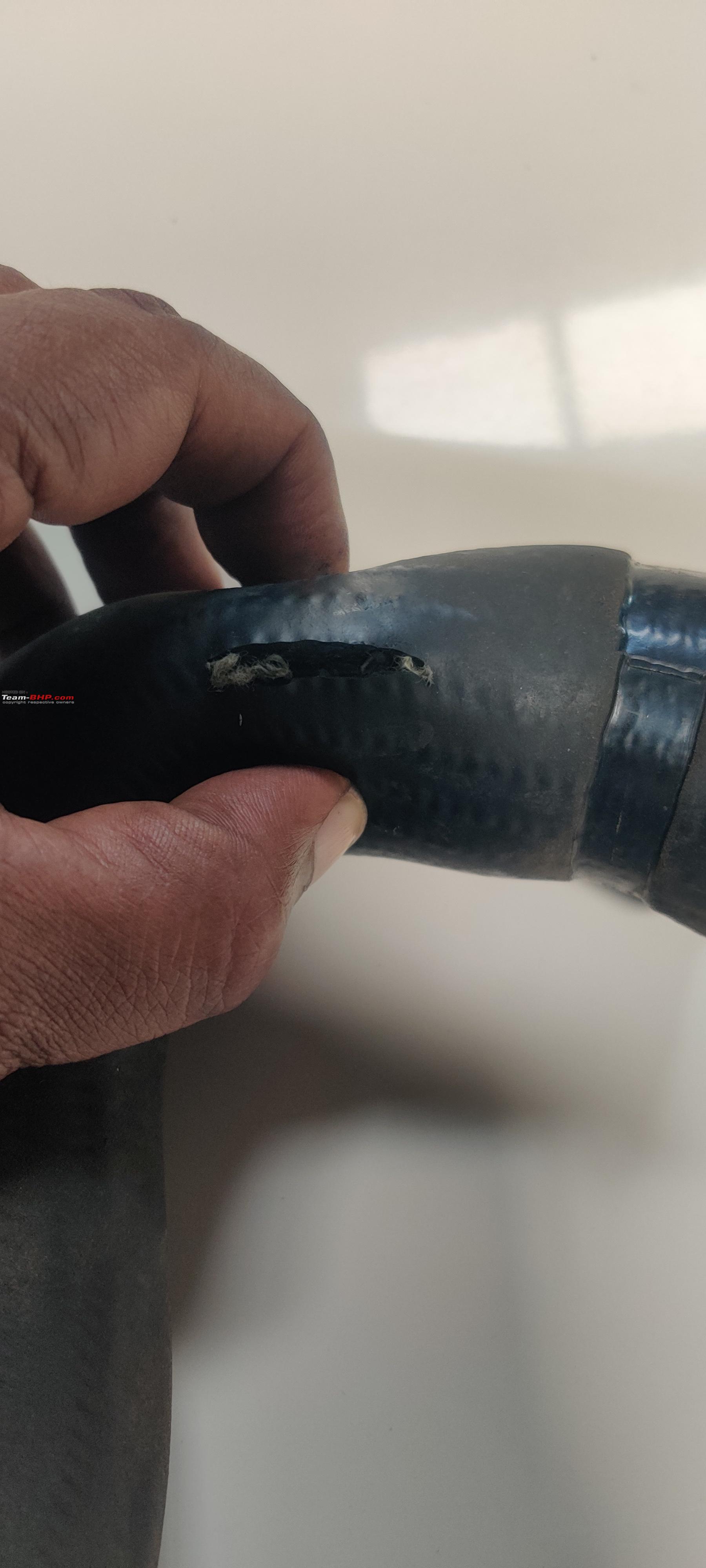

The Mahindra authorized spare parts dealer delivered the intercooler hose after 2 days and got it fixed at FNG. However , in the meanwhile the car developed check engine light and DPF error similar to what duckdoc mentioned and the FNG wasn't able to clear it
Tried booking a service at mahindra dealership , however there was a wait time of 2 days and the driver picked up the vehicle today with expected delivery on Monday. Hope they are able to fix the issue.
