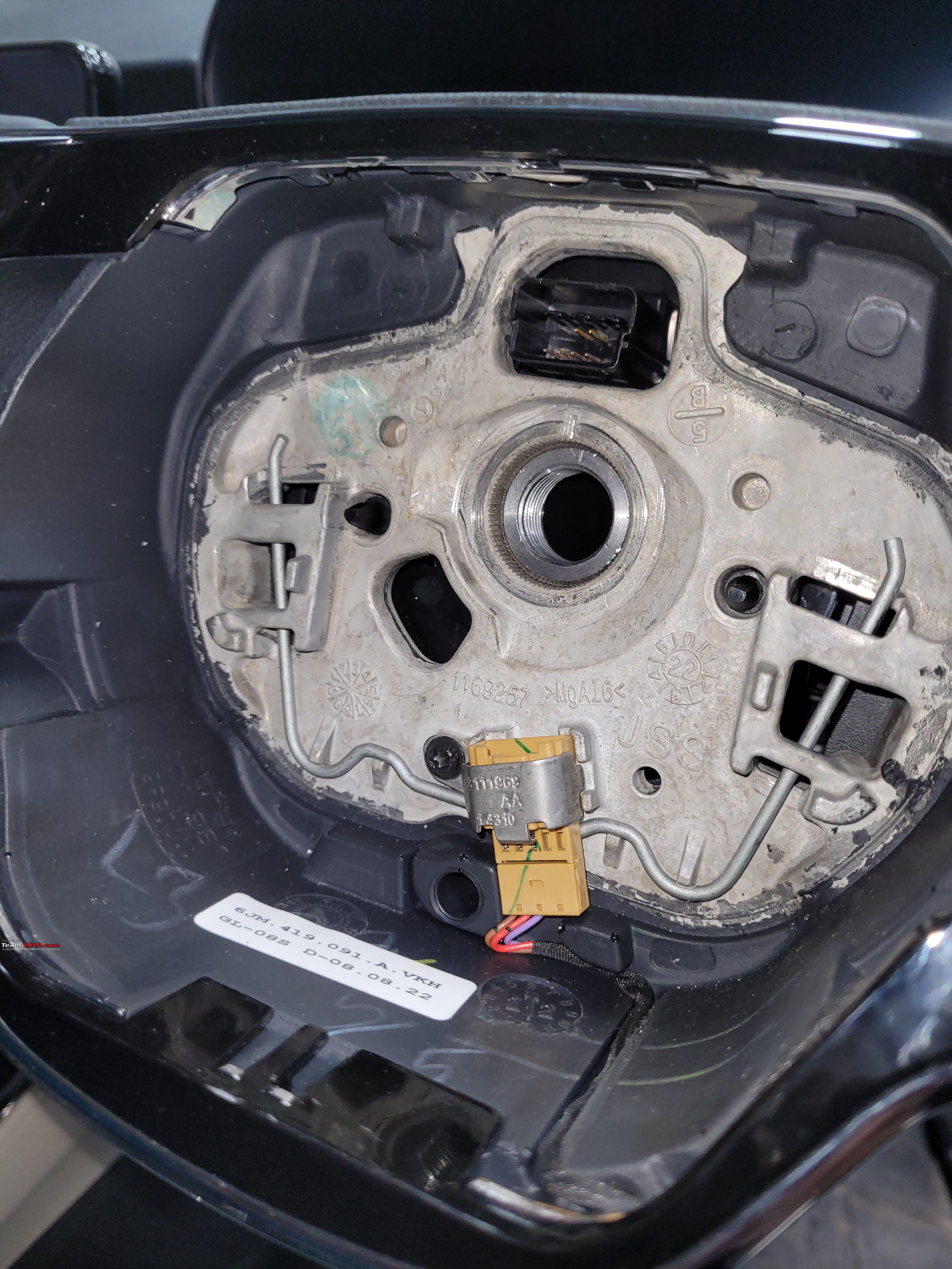

Re: Wiper issue in a Skoda Slavia | Wipers won't turn off!
Originally Posted by ashivas89 View Post
As suspected they had not installed the wheel correctly. It is very easy to misalign the steering wheel when sliding it on to the spline although there is usually a marking pointing towards the right orientation. The alignment was off by one gear tooth of the spline.
Cheers!
You can see in the images that the 12 'o' clock positions (marked by indentations) of the inner and outer splines do not line up. If anyone is interested
ashivas89 is online now   (3) Thanks
