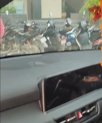

EDIT: Additional information added on 15th Sept:
I did a thorough PDI. No damage. Immaculate condition!
Focus on the blue scooty in the centre.
Video link: WhatsApp Video 2023-08-31 at 18.35.34.mp4.zip
Animated GIF (Eg. look at the rear grab-handle of the blue scooter):
Name:  GIF 9142023 123333 PM.gif
RTO wasn't done yet. They simply cancelled the invoice and sold the vehicle to another customer. ODO reading was less than 60 at time of return. I put the insurance at hold.
My full payment is stuck with them though!
I returned the 1st car on the same day itself within 3 hours and ODO less than 60 kms. They got the next car on 12th Sept. which I again drove and faced the same problems. Haven't taken delivery of the same yet hence no pictures of any car yet.
I have however a small video I took of the 1st car's windshield. You can clearly see the distortion in the centre.
Also, I have noticed that ALL the cars standing at the dealers showroom had significant distortion in the BOTTOM 2 inches of the entire windshield.

I would start with getting the windshield cleaned thoroughly with shampoo. Also use a glass cleaner to wipe the inside the windshield. Remember a smudged windshield is a bigger pain at night than in the morning sunlight. If you are not facing issue driving at night then it is likely not the windshield.
Did the car dealer apply any polish on the dashboard? A shiny dashboard or any object kept on the dashboard can cause a lot of glare and reflection onto the windshield. And this happens in sunlight and not at night.
A video or picture can help understand what the issue is.

Is it possible for you to upload a picture or video of the distortion?
