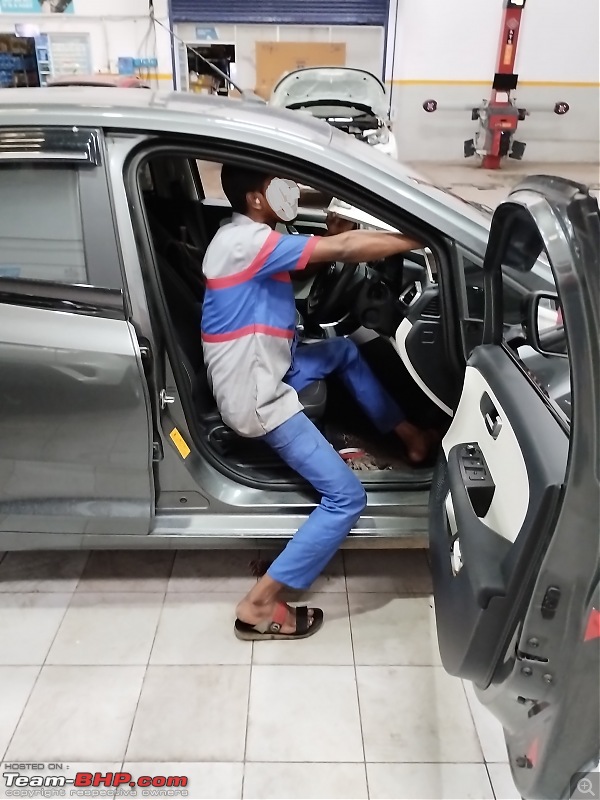

I had been to TASC today to get the A pillar trim replaced under warranty. Seat covers were not used and the mechanic had greasy clothes. The mechanic started to patch the existing A pillar trim as I kept telling him that a new replacement part has arrived and he ignored me and went on repairing the current A pillar trim. I went and got hold of my SA who came and confirmed the same. The service tehnician started removing the A pillar trim using a screw driver and the mechanic soiled the roof liner with his greasy hands.
When I requested the mechanic why he isn't using trim panel remover and not bothered to keep his hands clean, he dismissed my request and just went on doing his work. The mech took 15 minutes to remove the A pillar trim panel which is a 2 minute job. I told the mechanic that the tweeter plug should be unplugged using a very thin flat screw driver but the guy just went on using a heavy duty screw driver and pulled out the plug holding the two thin wires instead of the connector which could de-pin the connectors due to their rash behavior. I requested them to stop this drama when one of technician finally removed the tweeter connector using a lot of force by pulling the wires. I told them to move away and they didn't bother to listen to me.
The mech got the new A pillar and was struggling to fit it and I told him to first step out of my car and I fixed the new A pillar myself. I then requested the other mech to look into the wiper noise and juddering issue. He went on stating that it is a wiper issue. I firmly told him to just go and get the demo car as we shall swap the wiper and wiper arm of both the cars and my car wipers were juddering even after replacing the wiper and wiper arm with the demo vehicle ones. The mech who had been ignoring the issues since the last few months accepted my analysis not so happily. With all this drama unfolding in front of me I just couldn't tolerate it anymore and I sat in the backseat of my car and started shooting a mail to CCM and Tata Motors as the technicians were fiddling with my car and the service head found out that I was mailing Tata Motors and requested me to not send the mail as it would be again redirected to him. He requested me few more days time to sort out all these issues and that is when I just couldn't control my anger and frustration anymore and gave him a piece of my mind while still maintaining basic manners.
