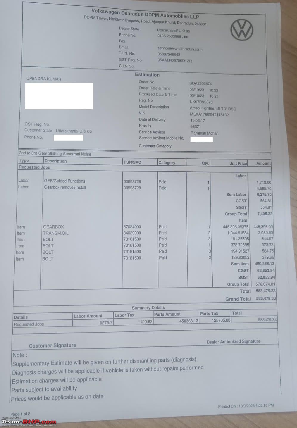

Sharing below events for the absolute shock we received in the last two weeks for our Volkswagen Ameo Highline DSG 1.5 Diesel with a bomb of Rs. 5.8 Lakhs.
1. Somewhere around 28th-29th September, the car started making a wheezing sound while shifting gears. Particularly from 2nd to 3rd for both up/downshifts. Apart from that, the car was smooth as butter for other gears and mechanically strong. In short, we didn't face any other issue apart from the wheezing sound. Considering the fact that we handle our care with love, we decided to get it checked at the local dealership i.e. Volkswagen Dehradun.
2. On 3rd October, the car was sent for a check-up, and towards the end of the day (3rd October), it was mentioned by the service advisor Rajvansh Mohan ji that they needed more time to assess the problem. We didn't hear back for the next two days and upon enquiring on 6th October, the service advisor mentioned that the gearbox had failed and it needs to be replaced and the total cost would be around Rs. 5.5 Lakhs.
3. We tried to gather more details such as what part has failed, the breakup of the cost, etc. Unfortunately, a single statement was provided that the gearbox would be replaced and the cost would be around Rs. 5.5 Lakhs. Upon several requests, we got the attached quote from the dealership with a single line item gearbox - Rs. 4.46 Lakhs and total repair amounting to Rs. 5.8 Lakhs which is equivalent to the current IDV value of the car i.e. Rs. 5.9 Lakhs.
4. We are in utter shock given that the car was mechanically strong when we sent it to the service center and how our case is being handled by the dealership by not being transparent about different parts within the gearbox. The biggest one is that there is only one solution i.e. replacement of the whole gearbox.

Need more information, if the car was regularly serviced by the Authorised workshop, how old the car is, are there any fault codes on scanning etc. The car has done around 56,000km from the Estimate is what I see.

I don't think the DSG replacement should cost 5.8L even if it needs to be replaced in whole. I see it is a 2017 purchase. How long since the car is out of warranty? There was a time period when VW was providing warranty up to 7 years. Even if it is 5 or 6 years maybe worthwhile pushing for some goodwill replacement if one can find the right channel.( Maybe this thread would also help).

From a preliminary understanding with limited information, the service center looks to be duping the VW Ameo owner. It is a 2017 manufactured car and if out of warranty (extended) then too the owner can request for a good will warranty replacement. Still, the price quoted is on the higher side. I own an Ameo HL + DSG and this post worries me. Currently I am in the 5th year with an extended warranty and definitely going to purchase further for the 6th & 7th year as well. Have few questions myself:
