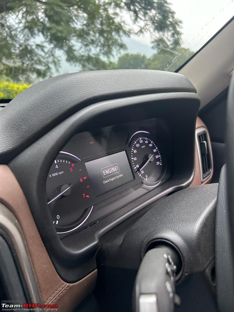

I got my new Scorpio N Z4 AT post the second service (10K) from Sireesh auto in Bangalore. And about 1K kms later while we were in hills, it suddenly started showing the "Engine" error with a warning but was not continuous or blinking but will come on for 5 seconds and will go off only to come again maybe an hour or 2 later.
When checked in manual, it was clearly written that it will blink or be on continuously in case of an actual problem and the same was told as a sensor miscommunication by the Mahindra technician from Sireesh Jakkur.
On my return to Bangalore, I went to the service center to reset the alarm but the scanner didn't throw any warning nor the warning history and they sent the car back saying all is well. But again yesterday I got the same warning and this time I took a video and sent it to them.
They have instructed me to leave the Vehicle in the service and they will get back once they figure out what the error is. Now what should I do?. Is it common to get such errors in ScorpioN or something serious. I hate leaving the beast in the service center for unknown period as they are not committing a timeline to sort it out.
Need some advice here and please find attached the picture of the error

After spending nearly a week in the service and the Sensor replaced, the issue remained unsolved. Then the vehicle was inspected by the software guys by Mahindra and found out that the entire Oil filter sensor assembly has to be replaced.
Since the Vehicle is under warranty, they have ordered the part but gave the vehicle back and asked me to come after 10 -12 days once the part arrives. This happened about 10 days back and am still waiting for them to call back.
As of now, the warning keeps popping out but does not show in warning history. So I just ignore and keep driving as instructed by the service centre.
