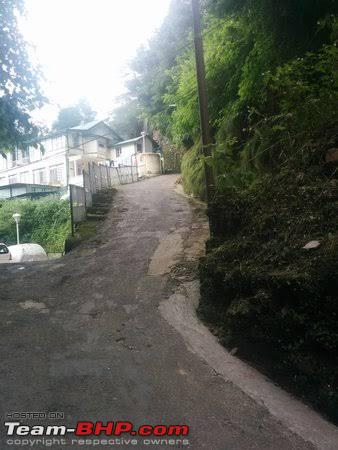

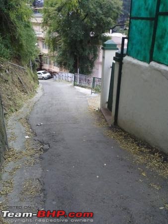

Now, The Main Encounter We Had with This Problem :-
So, the Road to Our Hotel [500 m] went steep Up from The side of the main Road after going up the road, like 200 m a car was coming from ahead so i Stopped the Car to a side [We Were Stopped at a steep Patch of the Road] But then when tried to move, I kept the vehicle at half-clutch, there was no power generated when I pressed on the accelerator. To my dismay, there was no revving sound even when I floored the accelerator pedal. Further, the vehicle kept switching off when I tried to make it move with just half-clutch. [Even the cars That were stopped behind Us Went up easily like Maruti 800 ,swift, even a Older Bolero Went Up with No Problem]
I had to back-up a bit to a Plain Patch of that road to gain some momentum, upon which the vehicle climbed up the slope "Barely" [In 1st Gear]. There were just Three occupants in the vehicle (including myself), and no luggage.
