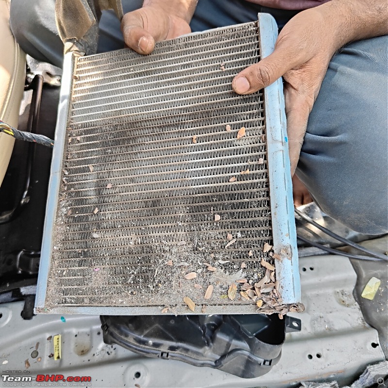

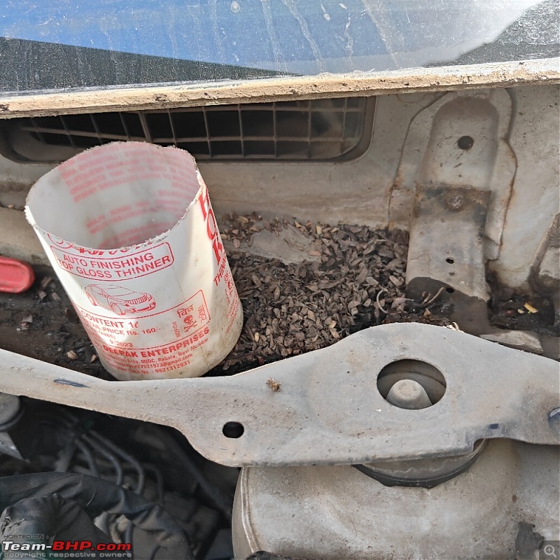

Dropped the car at an AC servicing shop today around 10 am.
They first checked for leaks, none were found, so a basic complete service will do the job.
They opened the bonnet & dashboard, disgusting state.
As suspected the condenser? thing is badly messed up with leaves & accumulated dirt & dust over the years. I'm happy that it will be cleaned up.
The area under windshield where dried leaves were accumulated, it was looking like spoilt pickle , had asked the shop guy to clean it. Now I know why I had loads of dried leaves in the AC filter, as they were being sucked in through the rectangle hole.
Informed them that fresh AC filters are kept in the boot, do install them.
They started around 10.30 or so and said will be ready by 2-3 pm today itself.
Will be leaving a detailed review once service is done & I experience the AC.

Moku is ready to rule the roads, with full energy, freshy oiled joints & super silent engine.
Service center details & review : https://www.team-bhp.com/forum/mumba...servicing.html (Autospace | Malad Link Road, Mumbai | Complete Car Servicing)
Thank you everyone for your inputs, I'm extremely happy with the output of undergoing a major service & the new life given to our vehicle by these guys.
