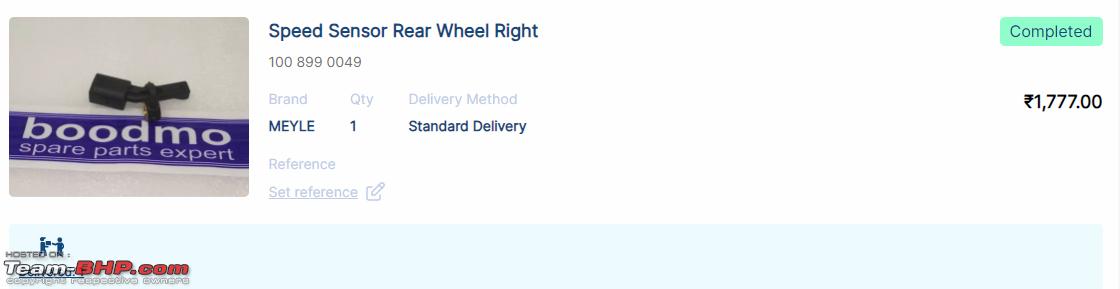

Originally Posted by AsphaltNomad View Post
Hi, I own Octavia (2016 model) and just today the ABS error popped up and before taking it to Skoda service centre wanted to understand the damage to my wallet. Can you share the details of procuring the sensor from outside?
Hi, I bought the sensors from boodmo.com, ASC quoted around 6.5k per sensor with 2 years warranty. There are many Instagram sellers selling the OEM sensors set at a much lower price, but don't know about their authenticity.
KratosMr is offline   (1) Thanks
Can you please share from where did you order the sensors? Also is there anyway to determine the faultly sensor without VCDS? Maybe ELM327 obd scanner or the likes?
I guess any latest obd scanner will do the trick. And be prepared to change the set of 4 sensors in the line, as they are prone to failure one after the other.
