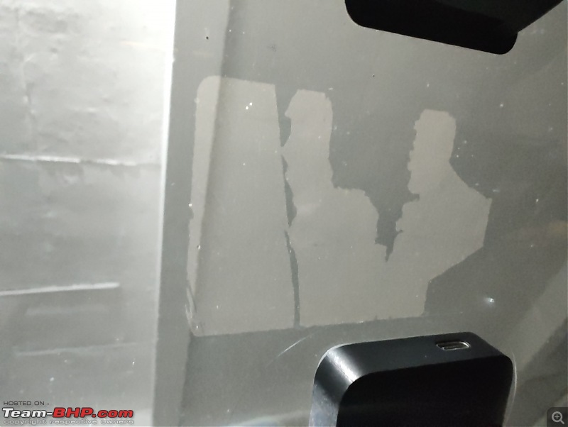

I closed the existing Fastag I had taken from PayTM Payments Bank due to the RBI restriction on their wallet transactions. While removing the Fastag from the windscreen I tried to slowly peel off the sticker but there seems to be a very thin film that got ripped along with the sticker.
Damaged windscreen film while removing the FASTag-img_20240318_202607349_hdr.jpg
Damaged windscreen film while removing the FASTag-img_20240318_202632336.jpg
Damaged windscreen film while removing the FASTag-img_20240318_203105119_hdr.jpg
Since this is a pre-owned car that I got few years back (it is a 2012 model 2nd Gen Jazz), I am not sure if there was some UV or other type of film on the windscreen or if I have damaged the stock protective film of the windscreen. Without the contrast in tint of the ripped area, I would have never realised that there is some film on the windscreen. Film itself is quite thin and the edges of ripped part are stuck tightly to the glass surface - so much that is does not look like an aftermarket job. Does the front windscreen come with factory fitted protective film?
I was planning to stick the new Fastag in the same place on the windscreen but if it was the UV film that was damaged would it potentially damage the new tag in the long run? Or should I get the full film replaced if that makes any sense?

Fastag stickers usually leave behind varying amounts of adhesive residue behind upon removal. It's hard to make out what exactly from the images but you are certain it is something that came off of the windscreen and not adhesive residue left behind by the sticker? I know you mentioned a contrast in tint w.r.t the affected area but asking just to be sure.
If it is indeed some sort of UV protection film, then an area should ideally have been cut out for the Fastag as such protection films have a layer of metallic oxides on them which prevent the RFID reader at toll plazas from reading your vehicle’s Fastag. That said, have you had problems with erratic reading of your Fastag at tolls plazas?
This might be an opportunity to clear out a rectangular area neatly to affix a new Fastag, although I'm unsure if it's a simple DIY.

The adhesive sticky layer was on top of the dark tint area that remained on screen which I was able to rub off with glass cleaner. The rubbing had no effect on the tinted area on the patch. The lighter area was clean without any adhesive residue when I had taken off the sticker.
Never had any issues with the tag being read properly at any of the tolls. It worked at all times.
I'm not sure if the protective film would also protect the plastic Fastag sticker from UV damage (I've seen the usual vinyl stickers on the outside get brittle and cracked with constant sun exposure due to UV damage on plastics). If the film doesn't add much protection then I can clear out the part where the Fastag would stick. Also I'm now wary of attaching the new Fastag using the sticker's adhesive in case I need to take it off in the future due to another change in Fastag provider for any unforseen reason.
I am feeling bad that this was probably an OEM tinted windscreen that I ended up ripping off along with the Fastag .
