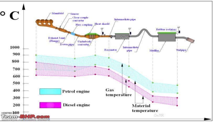

The high temperature flue gases coming out of the engine ( CO2, NO, HC, P, SO2, Pb) and combine it with moisture in the air makes it the extreme environment to deal with. That's the reason the exhaust pipes are made of different metallurgy (probably high steel alloys) and not carbon steel, this is also required for regulatory environmental compliances too. The materials used in the exhaust system must be resistant to high-temperature oxidation, external salt corrosion, and internal acid/base corrosion due to the corrosive fumes.
For welding you will need a special electrode to weld repair it and I don’t think unless you know the PMI of the exhaust material one can do the satisfactory weld repairs outside the OEM window. One can see the generic high temperature profile from manifold to tail pipe, higher temperature = higher corrosion.
