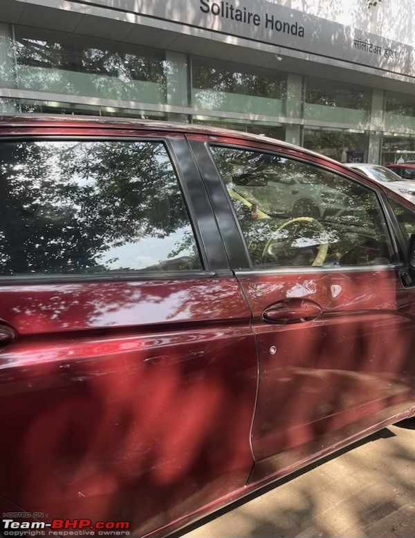

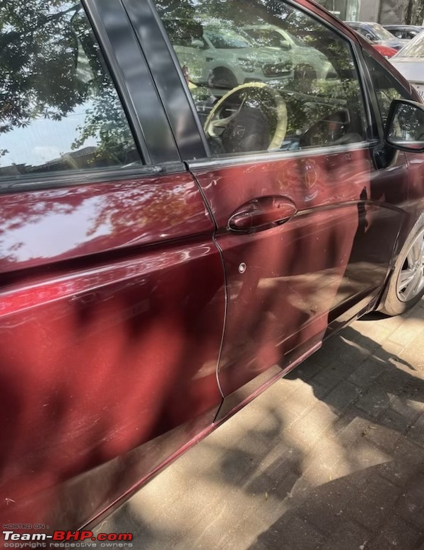

Opting for the authorized Honda Workshop, Solitaire Honda, instead of local body shops, and paying a premium due to our trust in the Honda brand, we were assured that the color difference would settle within a month. However, it's been several months now, and the issue persists. It's disappointing to discover that the quality of service at the Honda workshop has deteriorated to such an extent.

It's very hard to match colours, especially with old paint. Most A.S.S do not have their own painting booths. They outsource the job, just like air conditioning or brazing repair jobs.
Your freshly painted panel will never match. The old paint keeps getting older and changing shades.

Unfortunately the difference in result you see is due to oxidation of old paint.
Also, paint match - batch to batch is never 100% and it is more noticeable in some shades than others. You may try pepping up the old paint with some polish. Or if you are very particular, get the old panels painted. Otherwise I don't see an option other than living with it. The new paint will slightly get closer to the old shade for sure after it oxidizes living in the natural environment but don't expect a 100% or even 99% match.

New paint blending with old color is no more a rocket science. This requires skilled workmanship which I’ve realised that this Honda workshop does not have.

The problem I feel, is the way an A.S.S paints a panel when compared to an independent body shop. AFAIK, most A.S.S's put the car's details in their system, which gives them that cars car's particular paint code. They get the paint corresponding to that paint code and paint the required area. Here lies the problem. That shade (even though the same color) is how the car came out of the factory, not the shade of the car at the time of painting. This will be even more prominent, depending on the state of the current paint on the car.
An independent body shop, 99% of the time, removes the fuel filler flap, takes it to a paint shop, who then scan and mix the exact shade of paint. There will still be a very slight shade difference after painting, but such difference will go away within a few days of exposure to the elements.
So you have 2 options. Get the door painted outside following the above process. It should not cost much as Honda already removed all defects before painting (I hope they did). Or test a 'cut and polish' on a small patch on the door beside the newly painted door. See if that might bring the old paint shade close to the newly painted door's shade. But if Honda messed up and negligently painted your door a slightly different shade (screw up in the paint code maybe), then you have to take it up with them.

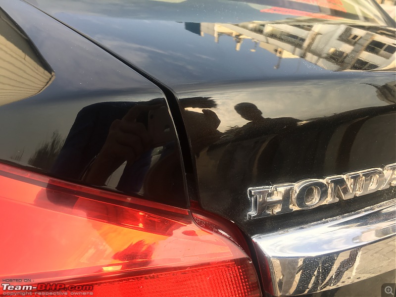

I too have had bodywork done by them and it was worse than some roadside shops. I don’t have pictures of that work but I do have pictures of Infinity Honda’s bodywork as it was similar (read terrible) quality-
Mismatched the shade on my boot lid, made it dark brown on a black car

Note the massive pinholes

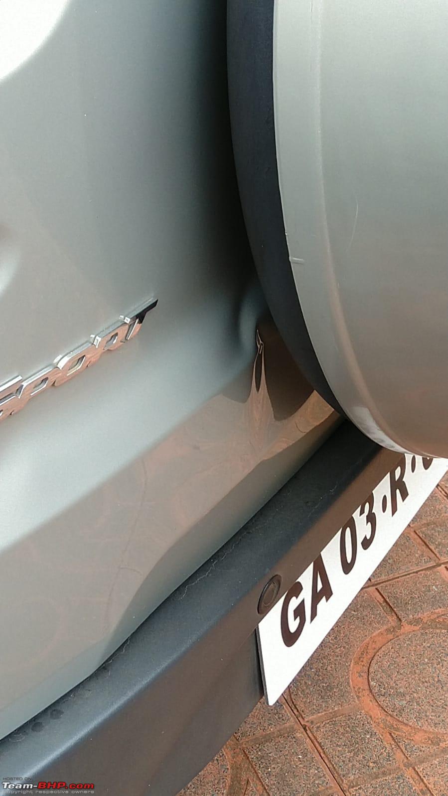

Before & after photos of the tailgate dent repair of my 7Y old Chill Metallic Ecosport. Paint was matched perfectly by Mr. Chari (Goans will be familiar with the name) using a blending thinner coat layer in between the base (applied to the damaged part only after the dent was pulled & surface leveled) & clear paint coats
