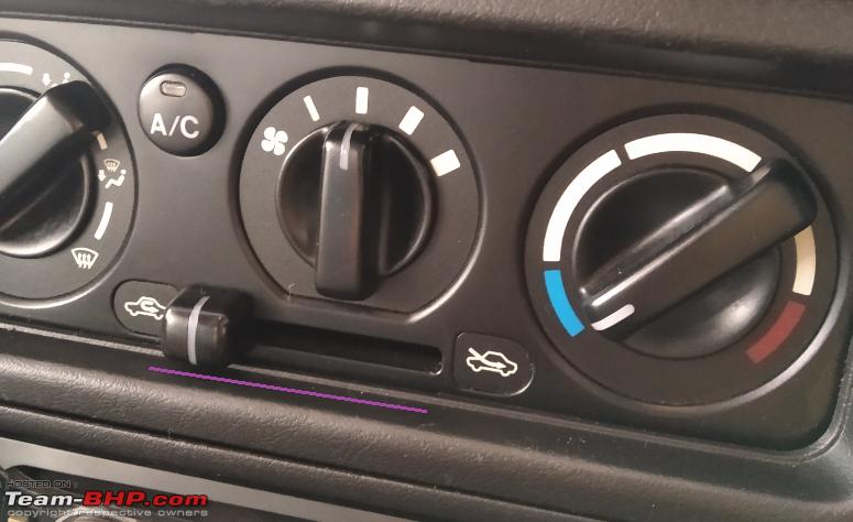

Hi all,
I have Maruti Alto Lxi. For last may be a year or so, I never touched the air circulation knob which is a horizontal knob on the dashboard.
It remained on Internal Circulation. The other option is fresh air from outside.
Now it has jammed. I tried pushing it hard to the right but it does not move much. If I push it harder it might break something inside.
Is there any DIY fix possible or I better leave it to the authorized service center?
There’s no immediate problem. It can continue to remain on Internal option. Just my OCD that everything in my car must be in perfectly working condition.
Any guidance would be great. Thanks

Most likely a mechanical issue. However you may need to open the centre console to get to the rear of these knobs and slider.
I wouldn't recommend a DIY. Take your Alto to an FNG or local AC specialist. Authorised service centre may not be required.
If it makes you feel any better, in my 2005 Scorpio, only the fan blower speed knob works. All other knobs and sliders have been frozen for a very long time!

This is mechanically actuated flaps, your best friend in such scenarios is WD-40, just put the nozzle in the horizontal crevice and spray a bit inside to see if it does the trick. Spray and leave it for sometime and then try to see if the knob moves.
At the most you might get WD smell in the cabin for few days even if it doesn’t work.

Thank you. I tried WD40 but that did not help. The knob does not budge at all.

The same slider got jammed in my Dzire too. After opening the cabin air filter and checking inside, it was found that rodents had a party in the blower area and there was a lot of foam/insulation material/cloths and other garbage. The flap which opens/closes air recirculation duct was jammed because of this. I cleaned the mess and it was operational. You may give it a try.
