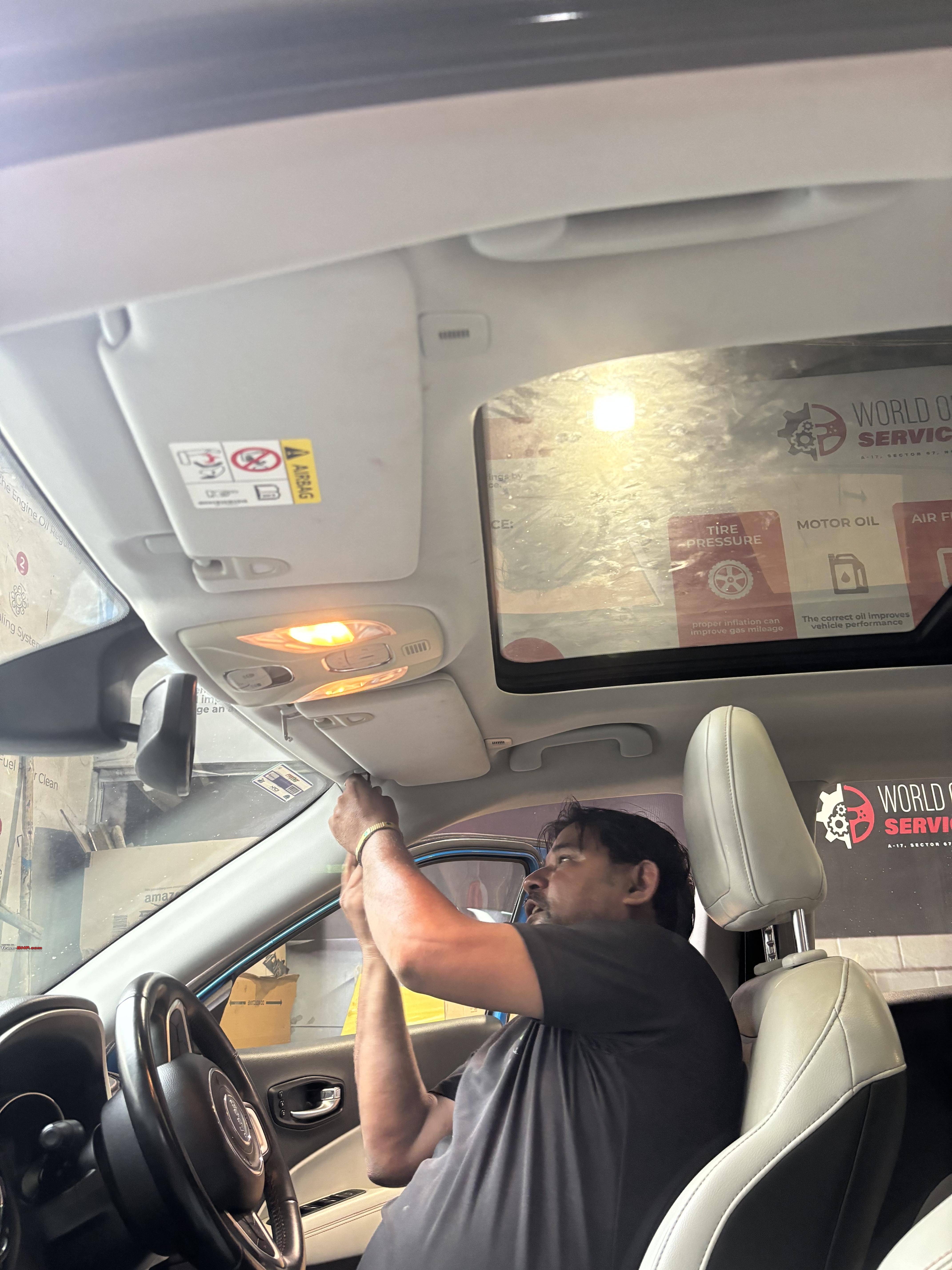

First, the sunshades were removed
Jeep Compass: Successfully fixed the stubborn sunroof rattle-img_6450.jpeg

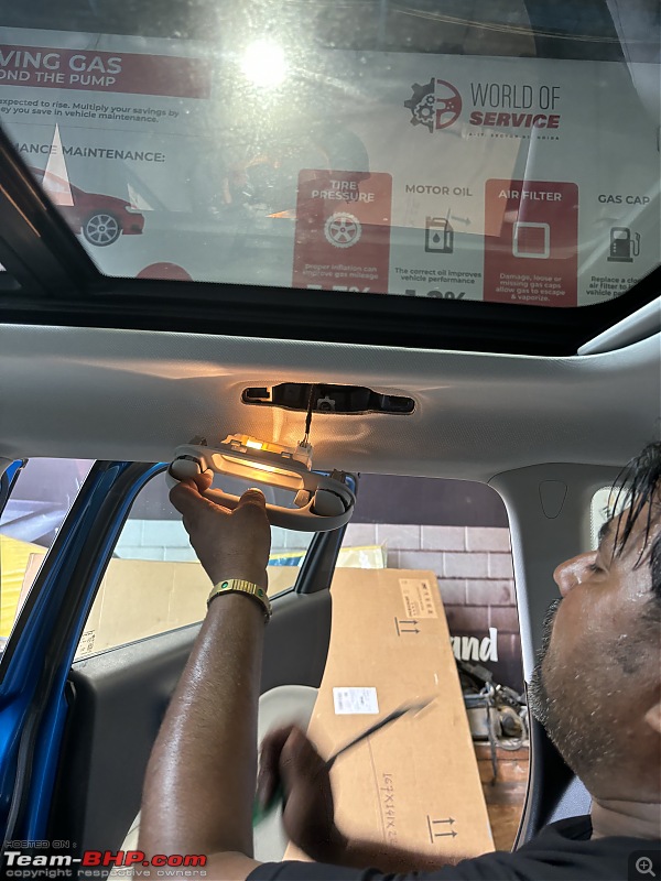

Followed by the grab handles
Jeep Compass: Successfully fixed the stubborn sunroof rattle-img_6452.jpeg

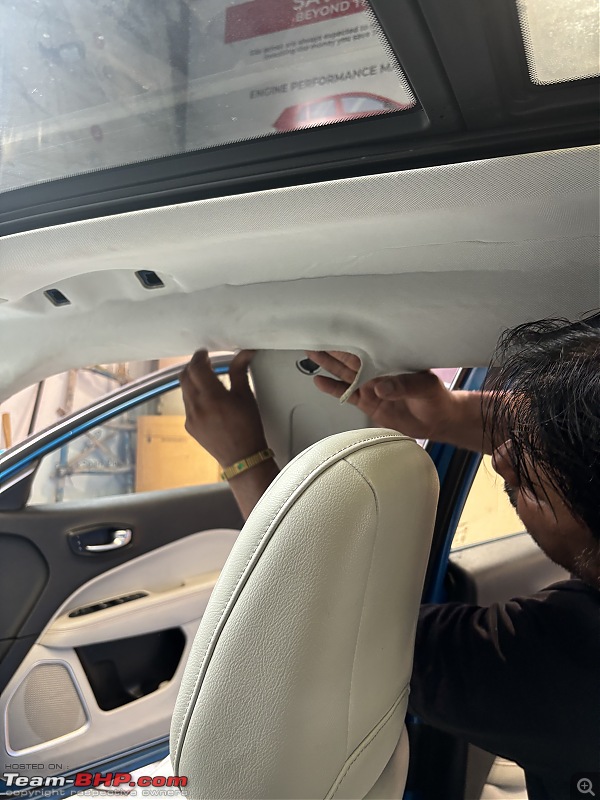

The trim of the A, B and C pillars was loosened with a prying tool.
Jeep Compass: Successfully fixed the stubborn sunroof rattle-img_6459.jpeg

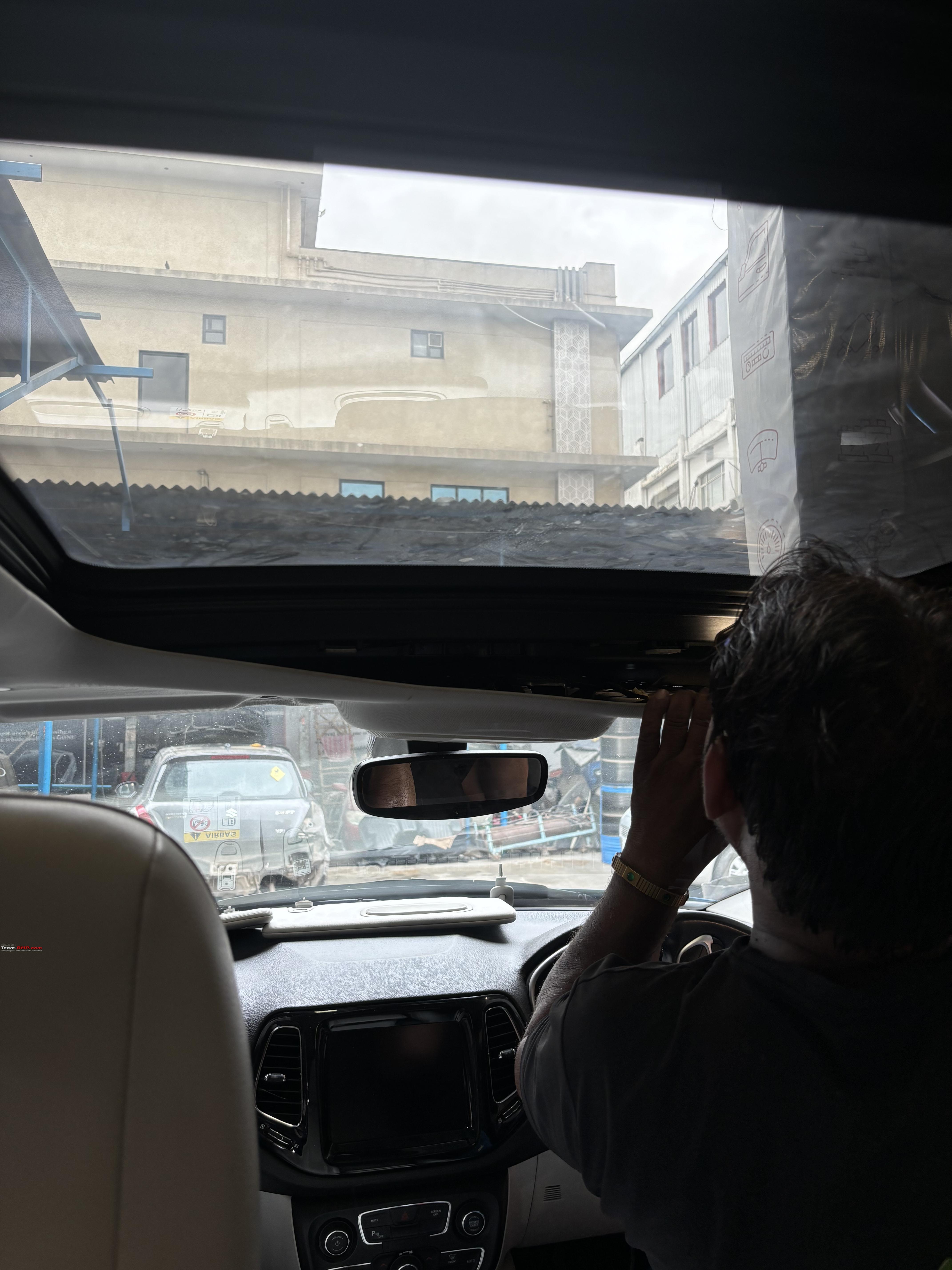

And then the roof liner was carefully pulled down
Jeep Compass: Successfully fixed the stubborn sunroof rattle-img_6453.jpeg
Jeep Compass: Successfully fixed the stubborn sunroof rattle-img_6454.jpeg

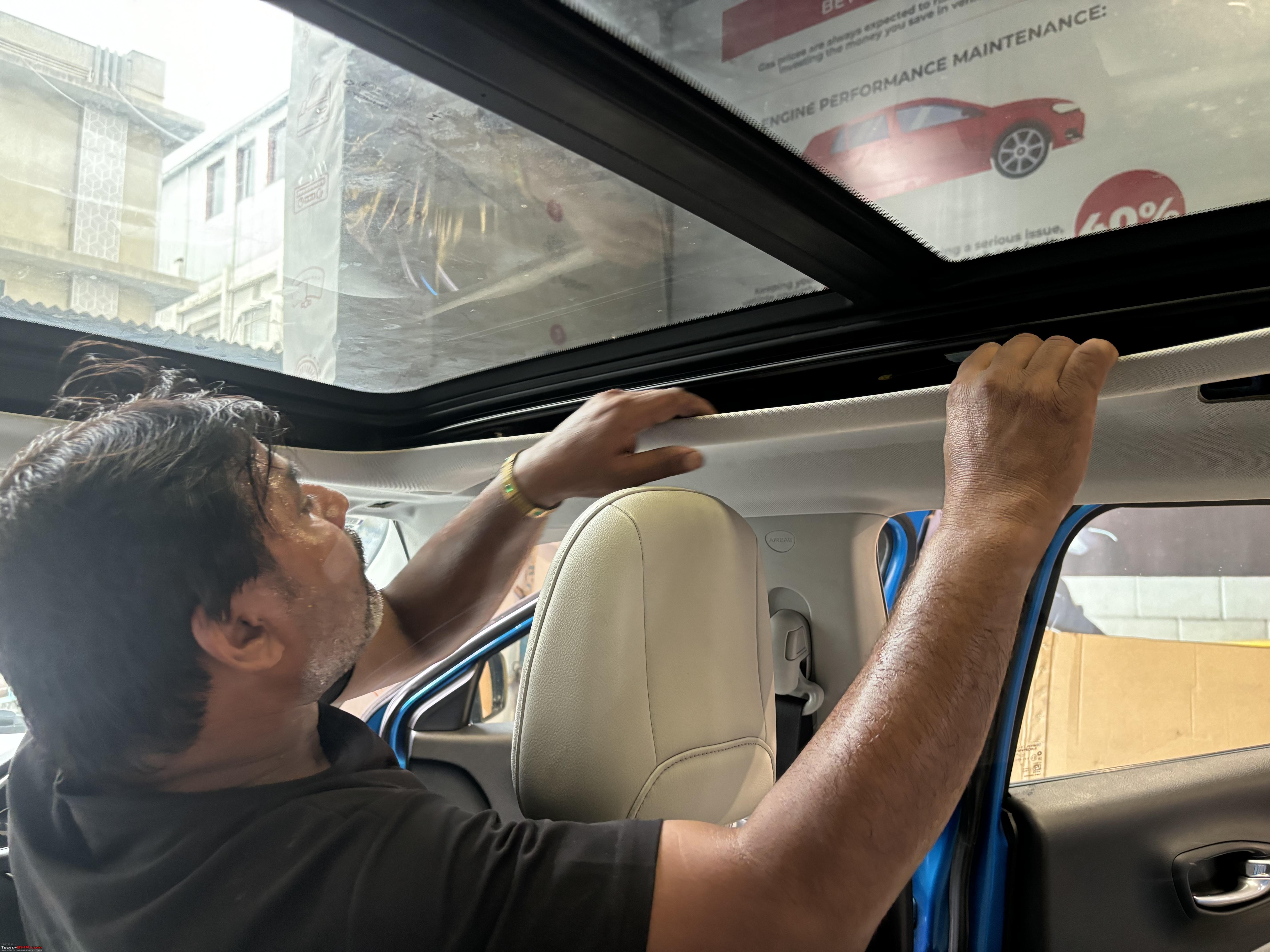

The roof liner is held in place by heavy duty Velcro type material
Jeep Compass: Successfully fixed the stubborn sunroof rattle-img_6456.jpeg

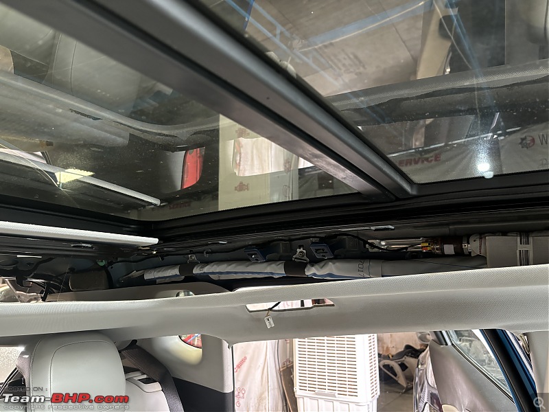

A view of the hidden bits inside: the airbag module
Jeep Compass: Successfully fixed the stubborn sunroof rattle-img_6463.jpeg

With that many loose bolts, I was surprised not to see a lot of rust? You would think with loose bolts there would be water ingress. Or not in this case?
I hope you took safety precautions? Which usually means disconnecting the battery and waiting 10-15 minutes before going anywhere near the airbag!
I’m curious, what is the purpose of waiting 10-15 minutes before going near the airbag? Is there a separate battery (or some capacitance) in the airbag circuit that requires additional time to discharge after being disconnected from the car battery?

It’s not the airbag itself, but also the control unit that have capacitance.
