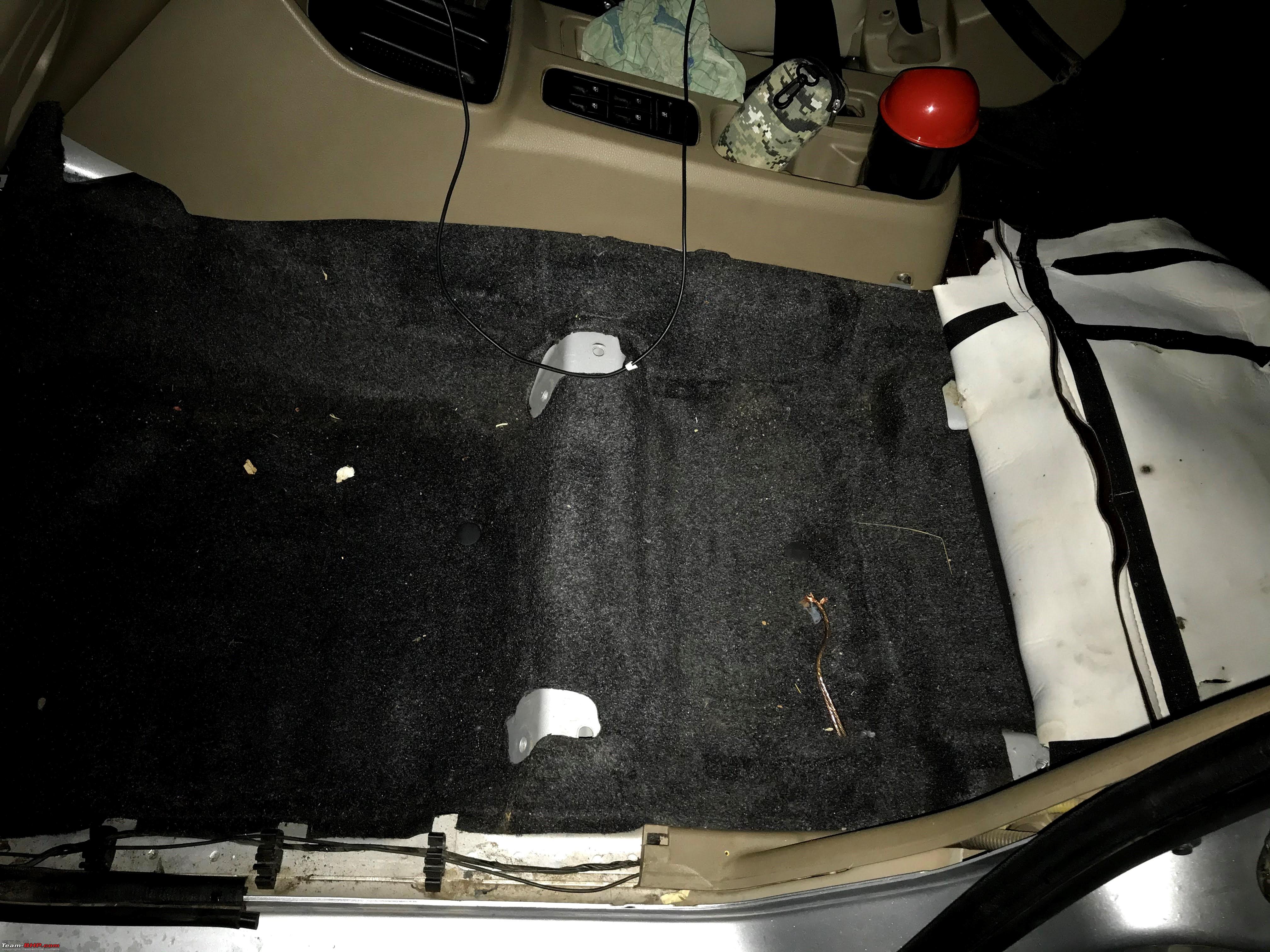

Removed seat to allow the carpet to folded lol:
