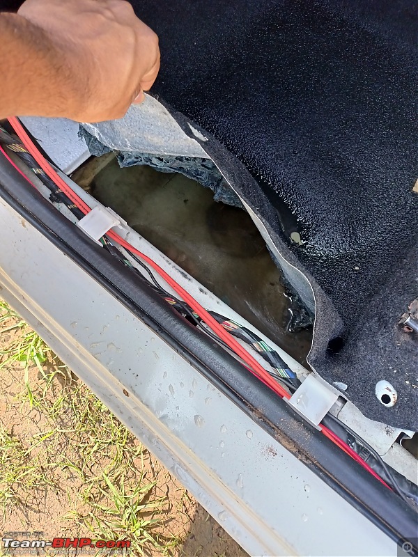

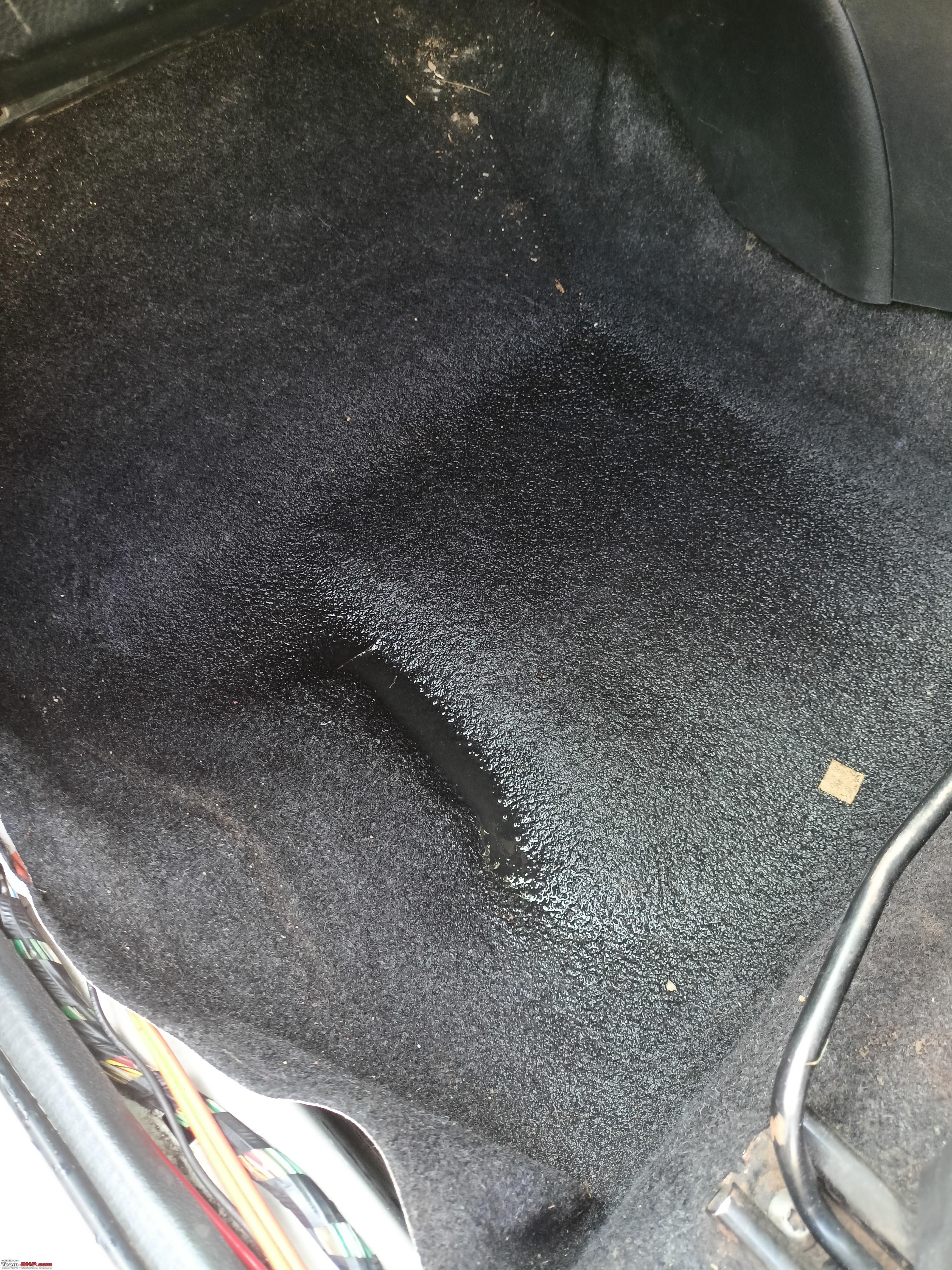

I am too facing the same issue, writing this reply while getting my car dried at a workshop, but I didn't drive it in flooded roads, the workshop manager says that the AC drainage pipe was lose, Is it possible ? -
