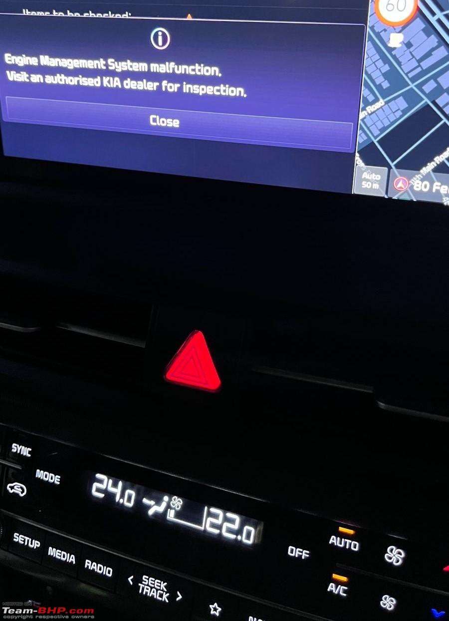

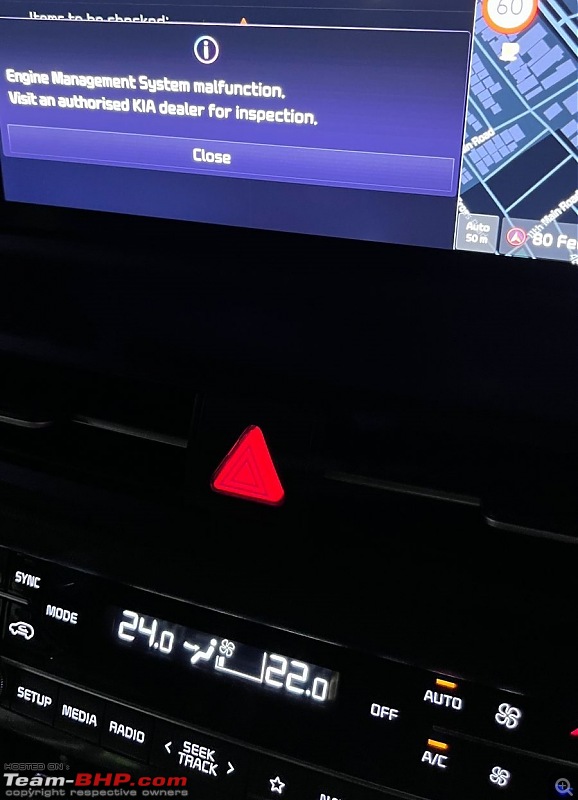

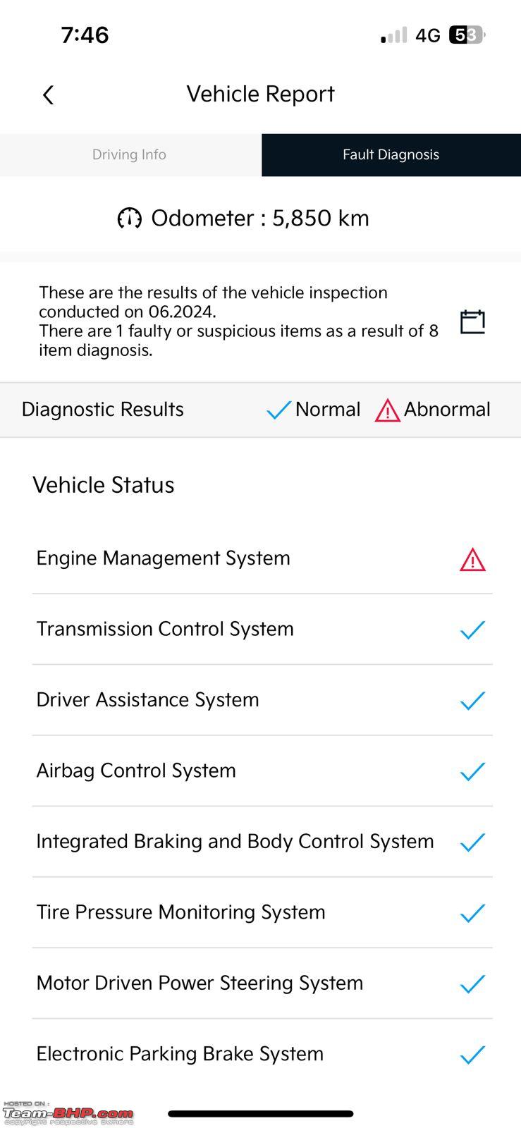

Around 5,000 KM on the ODO, the engine management warning had popped up on the dashboard. Immediately we took it to the dealership where they said it was due to carbon build up and after 30 or so minutes of ‘cleaning’ the carbon, the car was good to go.
It was all smooth sailing for another month or so, when this warning popped up again. We were a little perplexed at first because this is a car that does substantial amount of highway driving and fuel is filled from only reputable gas stations. The driver took the car to the service centre where they took almost two hours to clean the carbon and do a software update.
It seemed like everything was fine but this time, within two weeks of the visit, the warning popped up again. I had written an email to Kia India and Advaith Kia about this issue that is now a cause for worry. I took the car in on a Saturday where they took some time to diagnose this but basically performed the same ‘carbon clean up’ as well as software update. The service manager (who was very helpful, in fact all the Kia team were quite polite and helpful) told me that this issue is due to carbon build up. But to me, this warning is not the DPF warning but the engine warning light. From what I understood he has told me that if this issue persists, they will have to replace the catalytic converter. He also says the car is fine even with this warning on or the warning will disappear if you drive it for a long time.
There is also a tiny issue that has happened twice now where the one touch sunroof stops working and I have to reset the sunroof after watching online tutorials. Not sure if these are connected but its definitely another software bug.

My worries-
See as mentioned here and in my review, the car is absolutely superb, I really have no compplaints apart from this. Because the car is still new, and the team is supportive. But what happens when the warranty runs out? My other Diesel cars which are all 5 plus years old now still work rock solid. I am not sure if this is a Kia issue or a Diesel DPF issue that plagues all new cars. This is issue is something that doesn’t give me full peace of mind. It’s the one tiny obstacle prevcenting me from loving this car fully.
If anyone else has faced this issue or is facing this issue, please do let me know how you proceeded with this and how it was solved for you. So far I have full faith Kia will solve this issue (or maybe it has) and this issue won’t recur again but let’s see. Will update on the thread.

Engine malfunction light comes up whenever there is sone sensor issue.. These sensors could be in the engine or in the ancillary systems likes breaks, filters, clutch, fuel pump etc..
Whenever the light comes up there is an error code generated..
Did your service station do a scan of your ECU.. Using a obd2 scanner.. (std equipment available at all service stations) this would have given out the exact cause..
In a 5k driven car it is unlikely a carbon sensor error that too when driven on highway
Few questions
1. Did you drive in rain water... The break sensors might have triggered it
2. Do you have rat infestation where you park your vehicle.. Some wires might have been bitten off
3. Who was driving..style of driving might give some hint at what was the issue..
4. What was the error code.. That will give exact location of the problem.. Insist this to be shared with you.. (else get to a local garage and ask them scan... it will not void your warranty, also you can buy a simple obd2 scanner and torque application on an android phone .. JIO also has one now.. Run the scan your self, it will the Give the error code.. You you can reset few errors but if they keep coming then need to get it sorted at the service station.)
DPF error comes much later in the desiel engine life.. Higher than 20k done.. That too if driven in low gear for long hours within the city at slow speeds.. Drive at high speed for sometime.. Heat up the parts with high gas flow.. It will cleanup in most case
Reepat errors and engine light needs attention and if your service station se ds you back by cleaning senror that to 2 times.. They are hiding something... Escalate the issue and ask them to fix.. Even if it means change of the engine..
Please visit a service station and get the scan report shared with you.. Get the root problem fixed, otherwise you will only see this error and spoil the ownership pleasure

If you want to get to the bottom of this, get an OBD reader and see what is the actual error code which happens. This will tell you if the dealership is just performing cleanup and clearing the error or getting to the root cause of the problem
