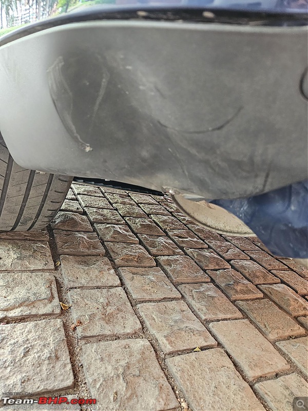

Hi, after 3 blissful years of incident-free ownership of my 2021 X3, law of averages finally caught up with me and woke up to see the below dent in the rear black plastic bumper It most probably was doing of valet guy of a star hotel I visited early this week but can't do much as I didn't notice it then.
BMW X3 rear bumper dented | Spend 1.2 lakhs, FNG, DIY or Ignore?-20240907_115931.jpg
BMW ASS has given me estimate of Rs 1.2L, which means involving insurance, taking hit on NCB bonus and leaving car at garage for a week atleast.
Will taking it to an FNG be any cheaper? Any recommendations in Bangalore (whitefield) area for the same?
DIY: I have seen youtube videos of people pouring hot water, using heat guns to pop the dent out from plastic bumpers but my assessment tells me that DIY will not be easy. I see the bumper is quite thick and riveted to blue one and heating them in place to pop them out may not fit my skill levels.
Or how about just ignoring and living with it? It's not very visible, unless you are looking for it but I do plan to keep the car for another 5-7 years, so...
Please share your thoughts.

I see you are from Bangalore. Trying to keep your car in showroom condition is very taxing here. My personal approach would be to do the best possible repair without a repaint. In this case, I would get the dent removed without damaging the paint, give it a proper polish and touch up the deep scratches with good-enough paint match, etc. Basically you will still see the damage but it won't be obvious at a quick glance.
This is the regime I've decided to follow after my initial years of trying to keep things in 10/10 condition which was like constantly playing whack-a-mole game. However, if your spirit has not yet been broken down, I'm sure others will pitch with recommendations for a good bodyshop. The cost of 1.2L quoted by A.S.S is excessive and when it comes to repaint jobs, A.S.S has no clear advantage.

This damage is nothing. If I were you, I would ignore and fix it whenever I get some time. Any good body shop in your city will fix it for you. It really does not warrant a replacement.

It should be easily fixable by a large amount. Get a good bodyshop to just straigten it out after opening it up, and you should only be left with a few scratches.

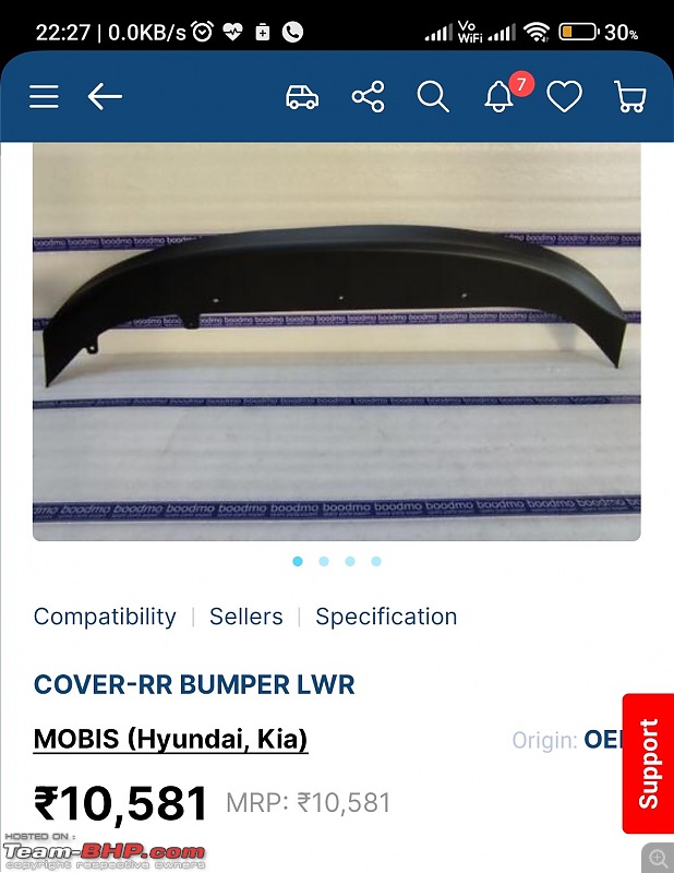

I think you can source the black part(rear diffuser) from some good car accessories shop which imports car parts.
BMW X3 rear bumper dented | Spend 1.2 lakhs, FNG, DIY or Ignore?-screenshot_20240908014432250_com.indiamart.m.jpg
Source : indiamart.
PS: even my Elantra's bumper black part is damaged and new one costs a lot for a little plastic. I have asked my FNG guy to source it maybe you can do the same.
BMW X3 rear bumper dented | Spend 1.2 lakhs, FNG, DIY or Ignore?-screenshot_20231108222731461_com.opsway.boodmo.jpg

A good FNG denter will remove this in minutes, I had a bigger dent on the rear bumper of my Nano some years back.
I took it to my denter he warmed up the inside with a hand glow torch, and pushed it, it popped out no paint damage, paid 150 bucks, it's easy don't stress.

Go in kitchen, boil lot of water in a large pot/vessel. Gradually start dropping this boiled water on the dented plastic and try to push from inside using something like thick bamboo or the handle of hammer which does not have sharp edge.
The trick will work if the thickness and quality of the dented part is similar to the upper painted bumper.
I have done it once on my Polo rear bumper (first type) which is made of very thick plastic. Initially when I tried first, I thought to give up but the job was done with bit of muscle power, patience and time.

I too was thinking of trying this hot water technique but given slant angle of the dented part facing down, water will just fall off quickly. Another hard part is lack of enough clearance on the inside for pushing it out with any force. I thought of removing the bumper first and then pushing it out from inside but that itself doesn't seem very easy thing to do for a novice.
So, ignore for now and find an FNG at leisure, it is. Voice of the people is my command. Thanks everyone :-)
