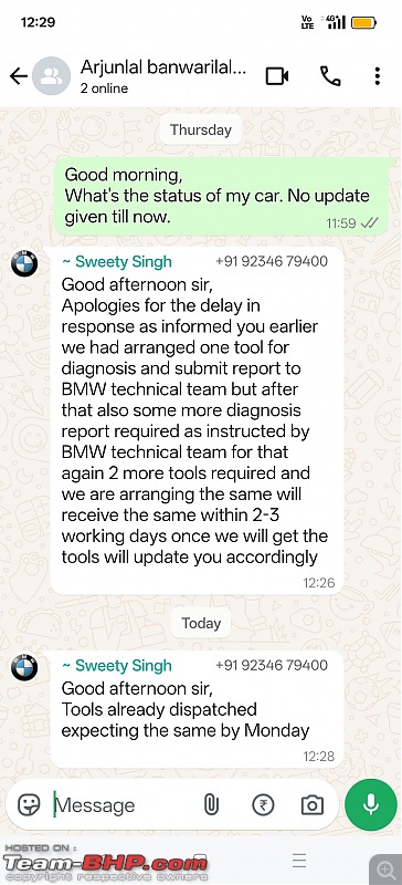

It just baffles me they seem to taking an engine apart without having a clue what the noise could be? It looks they have taken everything apart? Why? How will you find a simple noise like this? Unless they get very lucky and find some visual clues as to what was wrong, which I doubt with a noise like this.
The fact that they had no diagnostic analyser is a bad omen too. You need a lot of experience and knowledge to make use of them. Its rarely as simple as just reading a code.
They way they have taken your engine apart and it sits on a tire in their workshop with parts everywhere is beyond believe! BMW can't do this. It is beyond amateurism.
I'm very sorry but the whole approach screams:
We have no clue
We don't know what we are doing.
Thanks Jeroen! It has been almost 25 days since they started the engine dismantling work on 13th February. The service centre is still procuring special tools to perform yet another inspection.
Inspite of continuous prodding no one is sharing any data or report as to what might have gone wrong or the parts that may have been causing the noise.
My mail to BMW India has no effect on the process and I just get a response from their Customer care team with no favourable output.
Under 2 years old BMW 330Li at Service Centre for over 30 days. EDIT: Engine replaced under warranty-screenshot-20250308-4.44.328239pm.png

The noise seems exactly the same as the Youtube videos for Valve Lifter noise. I had asked several times on call and on mail to share a proper plan for the inspection process and timeline for this whole activity that they intend to follow before I allowed them to open the engine.
Surprisingly, the Service Head at the dealership has already changed during my course of interaction. Getting any concrete information seems to be a futile exercise.

Rightly said. I read on many B48 forums about possible issues that could cause the noise. I suggested the Service head to check these parts or even consult with the BMW Technical team for their opinion but they never bothered to pay heed to this. The noise could be from anything but such a common engine which is in so many of their global models and BMW has not yet solved the mystery of the noise.
I even asked them about how they would recreate the noise when the engine is totally taken apart but I was never given any response.
I always got the standard automated response of "We are working on it and will update shortly".

In my case, there has been a delay of almost 4-6 weeks just because the dealership is not equipped with proper diagnostic tools, first in December and now again.
Under 2 years old BMW 330Li at Service Centre for over 30 days. EDIT: Engine replaced under warranty-whatsapp-image-20250308-12.38.10-1.jpeg
Under 2 years old BMW 330Li at Service Centre for over 30 days. EDIT: Engine replaced under warranty-whatsapp-image-20250308-12.38.10.jpeg
It just shows that BMW India has not control over how the Service centres operate, there is no SOP followed, no audits conducted, no consequences for the dealer partner. No care for the customer either.
