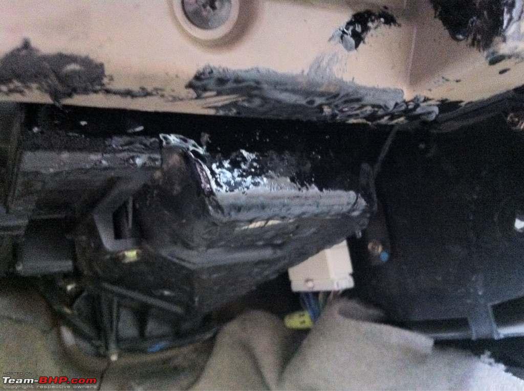

Hi Guys, sorry to revive this old thread but could not find any other thread where I can post the problem.
I recently bought a pre-owned chevy optra.
On a recent trip to dehradun, I noticed 2-3 drops of oil like substance on the floor mat.
On further inspection, I found that the blower housing( not sure if its actually blower housing) is covered entirely in that oil. The oil has dried up and has become sticky, just rubber like.
Could there be a possibility that the oil leakage took place in the past, when the car was not in my possession and thus the oil has dried up now?
If the oil leaked during my trip then there should have been more than 2-3 drops, considering the fact that the entire blower housing is covered in that oil.
The dried up oil might have heated up and melted and hence those 2-3 drops on the floor mat?
I tried to smell the liquid but no smell left now..
Please help in diagnosing the issue...

You have to be a little more accurate in your description of blower housing and how exactly you ran across that leak. If you have seen 2-3 drops of fresh oil on the right side mat its quite possible its a pinion oil seal leak. I need to know the exact position of the source of oil drip to be sure. If it is around the blower casing it can be a coolant leak/heater core issue.
You may not be able to ascertain the type of oil by its smell, rather try to find out its colour by laying a sheet of paper. In-cabin leaks can be even condensation water due to a crack in the aircon pipes. If the colour is reddish it is PS oil, bluish-green means coolant. The quickest solution is to hand it over to workshop.

I will try to click some pictures in order to make the issue more clear. The source of leakage is what I am not able to find out.
Those 2-3 drops fell on the mat only once when the car was driven continuously for 200kms, after that no more drops.
coolant level as of now is fine.
Yes I will definitely take the car to a mechanic but before going I want to be sure of what the issue is.
You know how those svc centre guys and mechanics try to make some quick bucks by exaggerating the issue and the amount of work that needs to be done.

Oil dripping on the driver side mat - Indica-imageuploadedbyteambhp1393047476.182920.jpgOil dripping on the driver side mat - Indica-imageuploadedbyteambhp1393047502.886115.jpgOil dripping on the driver side mat - Indica-imageuploadedbyteambhp1393047532.580750.jpgOil dripping on the driver side mat - Indica-imageuploadedbyteambhp1393047591.707981.jpg
i have clicked some photos hopefully these will help in giving a clearer picture of the issue.
first pic shows 2-3 drops on mat.
following pics are the zoomed in versions.
I think it is not the blower housing, it is the extreme right area under the passenger side dashboard...
Aksthedreamer is offline

Oil dripping on the driver side mat - Indica-imageuploadedbyteambhp1393050468.658352.jpgOil dripping on the driver side mat - Indica-imageuploadedbyteambhp1393050486.250965.jpgOil dripping on the driver side mat - Indica-imageuploadedbyteambhp1393050520.782029.jpgOil dripping on the driver side mat - Indica-imageuploadedbyteambhp1393050544.927831.jpgOil dripping on the driver side mat - Indica-imageuploadedbyteambhp1393050565.113016.jpgOil dripping on the driver side mat - Indica-imageuploadedbyteambhp1393050588.535260.jpg
I have clicked some photos, hopefully the problem will be more clear with the help of these.
1st pic shows 2-3 drops on mat, the following pictures are zoomed in versions of the leakage and area..
I now think this is not the blower housing because the blower housing is towards the left and this leakage is towards the extreme right side, under passenger side dashboard...
This sticky like substance also looks like some melted plastic or something, I am so confused...
