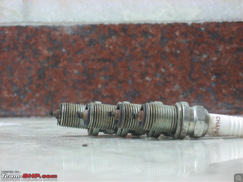

Will post snaps of the earlier plugs today. Wondering if the plugs could be the culprit. I've run 100+ kms on the new plugs and going by the fuel needle, it seems things are slightly better. Fingers crossed. Will know when I top up later next week. I always top up till auto cutoff, after the needle hits red - ie with minimum 40 litres (tank is 51).
Plugs may not be the culprit as u have put new ones recently, but they are a good indicator of the health of the engine..thats why I wanted to see them.

Attaching snaps of the earlier standard Champion plugs. 3 odd months old.
Went for the O2 check today. They used a Suzuki Tech2 to check. Readings were < 1. The snaps are taken at idle rpm and it shows Closed Loop. I forgot to ask them to check at 2K+ rpm specifically. Though IIRC, they revved once in front of me. Value remained < 1, but it did switch momentarily to Open Loop and then back to Closed.
I'm not sure how it was checked, but the mechanic said that the injectors were also working fine and that valve seals were fine too.
I told them that CO levels were higher after floods. They decided to check the reading. Unfortunately their machine went kaput. Will have to go back another day for this.
