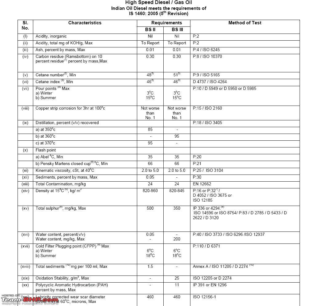

These are the detailed Diesel specifications.
TechSpec® : Diesel Fuel and the role of Cetane in Engine performance-diesel-specifications.jpg
Yes, you read it right the Diesel we use as per BS III has 5% diesel which will increase to 10% in 2010 as per BS IV, but this is also subject to ethanol availability.
Now this has its own problems like:
  • Blend Stability- poor and would need couplers
  • Viscosity & lubricity- lower but can be restored with lubricity improver
  • Cetane value – lower; can be restored with additives
  • Lower Energy Content& Flash Point
  • Material Compatibility and Corrosion are matters of concern for engine durability
I also read that IOC R&D has successfully developed additive package with coupler for blending of 5% ethanol in diesel. This blend meets most of the properties of diesel as per BIS except the Flash Point.
The major difference in BS IV vs BS III is the Sulphur content, the sulphur content in diesel is reduced to quite a lot. But the good part is that the Cetane number of Diesek wont change from BSIII to BS IV i.e. it will remain as CN min of 51.
So all oil companies have to adhere to these norms and as per cities and year deadline (subject to adulteration by pumps).
So your vehicle performance also depends on the fuel specification given by the manufacturer + your location, as if your vehicle is BSIII and you fill fuel apart from these 11 cities, your fuel is not able to meet the vehicle needs and also one more major factor is adulteration.
