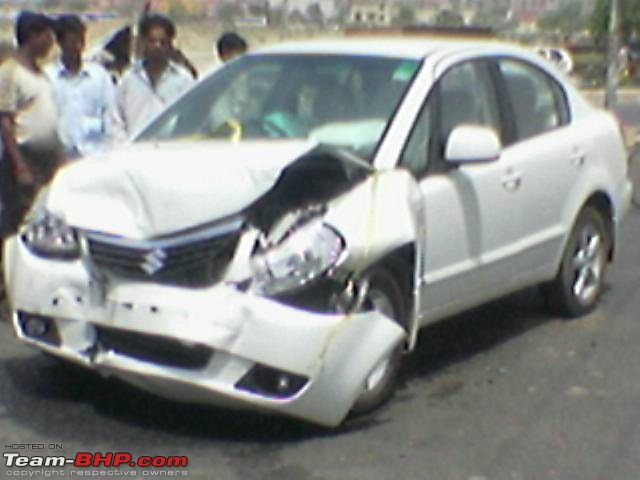

Thanks for replying, I know that already and was surprised to see the airbags deployed while there was not much damage (visible), asked the owner who was standing nearby (Perfectly alright, with not a hint of injury anywhere). This guy says, he was going at 40ish and hit another car at the crossing. the other car was a Sumo, which got hit on the side, and there was just a small dent on the side door. Nothing else... look below for the damage to SX4
well i really wont say that the damage on a SX4 is from a 20km/h collision..... i have seen accidents on the mumbai bangalore highway(after the expressway gets over on the katraj bypass ) where cars doing close to 80 rear ending Call centre sumos and still sustaining much lesser damage...
Well I personally feel in accidents, drivers tend to quotes the speeds around 20km/h less than they were actually doing. just a way to be safe or keep the blame less on their heads.
Well if you ask me the damage to the SX4 is "big"

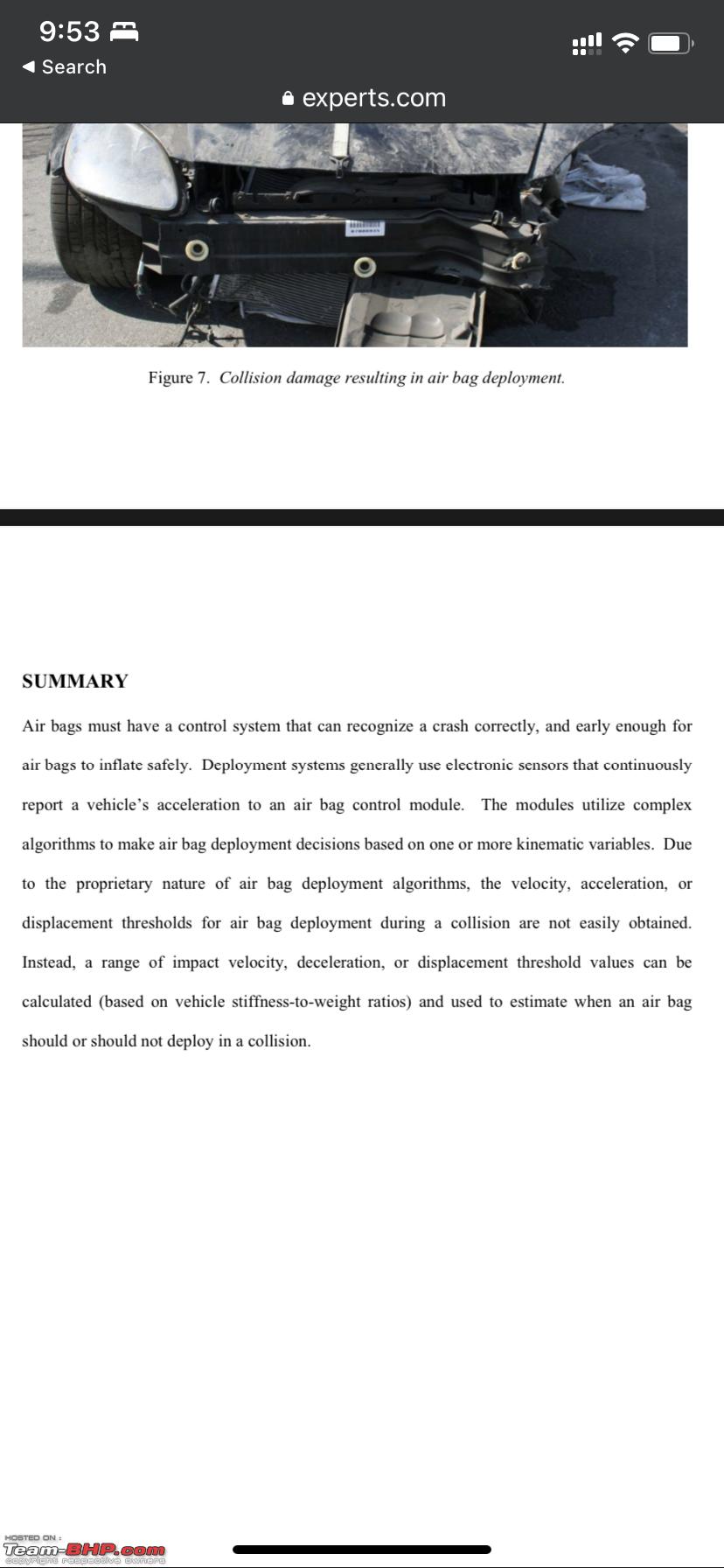

Airbags get deployed when the sensor detects rapid deceleration and the onboard computer decides based on other certain parameters. Read the paper below for more info. It will gives reasons why certain situations airbags don’t get deployed. Also learnt that each vehicle sensor and program will need to be calibrated for proper working of this safety feature.
https://www.experts.com/content/arti...rbag-Paper.pdf
https://www.iihs.org/topics/airbags
