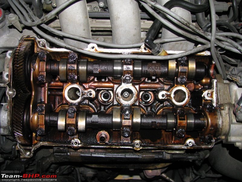

I was careful while loosening the screws. Got them all aligned in a logical pattern that would help later putting them back. Yes, they are different sizes based on their location. Got a chance to admire the DOHCs once the cover was out. Pulled out the Timing belt cover inspected the belt and found it to be in decent shape. This was turning out to be great fun.
When the excitement subsided, I found messy oil everywhere. The gasket was so worn out that oil had entered the holes the screw go into and not to mention the spark plugs as well. It was already late on a Friday evening, the Sun started to set and I wanted some beer too. I closed shop for the day, soaked the screws and the cover in gasoline, covered the engine with plastic and took more than an hour to wash the oil on my hands.
Day2: Was going to be hard work and indeed it was. Washed all the oil scum from the cover and set i to dry. Washed the spark plugs and the screws. It took 3 hours and I was already to get the torn gasket out.
If anyone else wants to try this I used a "70 clock" blade that I found in my room to get the old gasket out. It was a total B****! Took me more than an hour! Washed the corner and edges well set it out to dry while I cleaned the edges of the engine. Used gasket adhesive and the new gasket was in place. used some thing called a RTV (Room Temperature Vulcanizer) on the complex edges and I was all set. Placed the cover carefully and started placing the bolts. Started from the center and tightened the bolts in a star configuration so that I don't end up having one part of the cover more secure than other areas. Fixed the spar plugs and cranked the engine, she started up in the first attempt. Let the engine idle as I tided up the spark plug wires.
No more leaks, saved some $$$ that I can spend on her CV joint. Here are a few pics.

I would have used a wood chisel or better still putty blade, to gently pry away whatever was left of the gasket, out. A little engine degreaser would have helped too.
Originally Posted by bluestraveller View Post
...she started up in the first attempt. Let the engine idle as I tided up the spark plug wires.
Oh man! I have had some painful high-tension shocks from touching the spark plus wires while the engine was idling. Guess, you lucked out.
