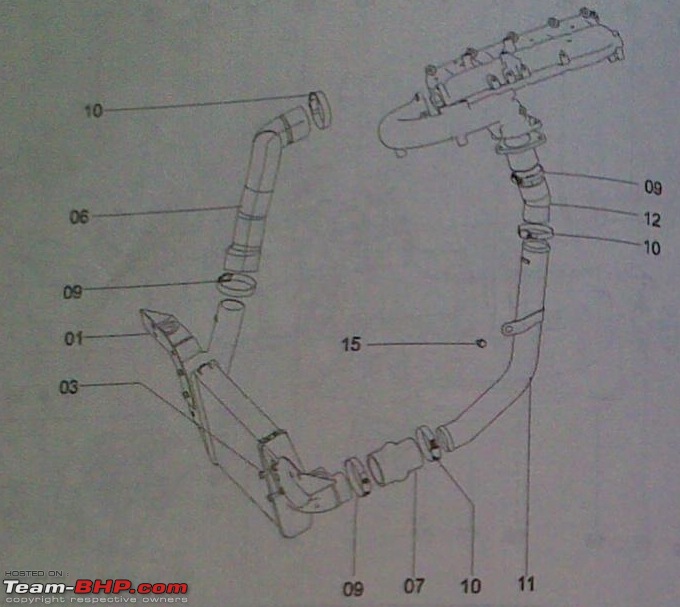

Originally Posted by Rahulk76 (Post 2245089)
Guys having intermittent gasping issue, kindly please check the clamp directly below the turbo, on the pipe which is orange in color and goes to the intercooler.
Mine got lose again, since the last time post when I tightened. Seems like Pandora Box to me :D
is the leaking boost pressure from this point the mother of all causes we face (jerking/gasping ) ? only TASS will tell :deadhorse
Originally Posted by simply_sunny001 (Post 2245101)
Rahul,
can you post a pic please if you dont mind.
thanks
This is what Rahul was talking about. But check clamps(no. 9, 10) at all Intake plumbing joints, leakage point indicators would be slighly greasy at the joint. Some are hard to reach but tighten the ones that you can.
The Tata Safari 2.2L Technical / Problems Thread-turbo-air-intake.jpg
Pressure leakage at these joints is also a probable cause of hesitation.
Attachment 526105
Thanks for this info Dadu. Its very useful.
