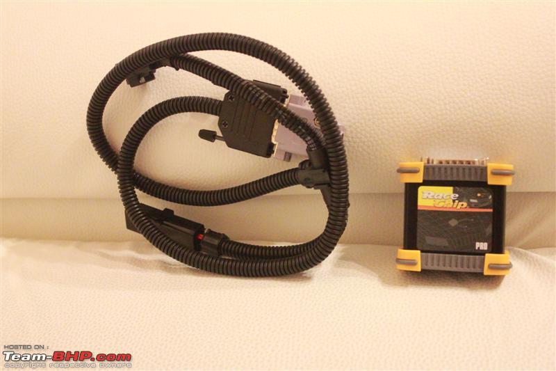

Originally Posted by SPEEDY_RACER View Post
Hi Avinash,
some time back i was also planning to get this tuning box from race chip, can you tell me which one did you opt the Race Chip/ Race Chip Pro..
i will order immediately once i hear from you, and carry it when i am coming to india.
Finally i ordered the Kit and recieved it in no time.
here are some of the pictures of the Kit, unfortunately i can install only in june as i am not in india
Mods please delete the post if you feel its not feasible here.
The Tata Safari 2.2L Technical / Problems Thread-img_2807.jpg
The Tata Safari 2.2L Technical / Problems Thread-img_2809.jpg
The Tata Safari 2.2L Technical / Problems Thread-img_2812.jpg
hey sorry for not replying fast. I got the normal tuning box not the pro as the pro offered marginal higher power than the normal one which was also cheaper for me but it will be definitley better . And the fuel efficieny has not changed its same as before 11 kmpl with. Ac and full load.
avanishphatak is offline   (1) Thanks
How much did it cost you?
