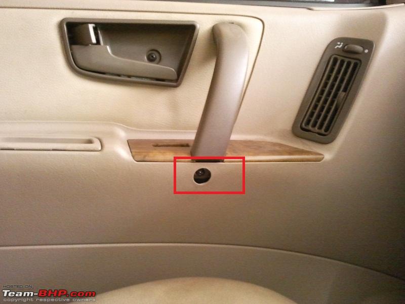

Guys,
Pls see the attached pic.
The Tata Safari 2.2L Technical / Problems Thread-safaridoorhandlemissingscrewcap.jpg
I was painstakingly preserving these little plastic things for over 3 years. But a careless washing/cleaning at my last TASC visit did this. Though, they have promised to replace it, but, they are too far and I am unable to maintain constant follow-up on phone. Can I source these screw caps readily? If yes, from where in Pune?
Thanks in advance for helping.
Same happened to me last year but thankfully I noticed it before taking delivery after the service and got it replaced. I doubt it if you'd get these anywhere other than the A.S.S.
