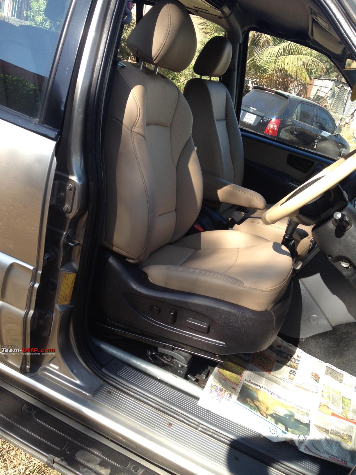

Originally Posted by bhagathmp (Post 3428071)
I'm looking at possibilities of replacing the driver and passenger seats on my 2010 Safari with electrically adjustable seats.
Has anyone in the forum done such a thing ? Not specifically on a Safari or SUV in general but any car for that matter. I want to know if it is doable - what additional wiring, the mounting points etc. If so, what would be the best place to hunt for such uses seats ? any cost estimate would also help.
Regards
Bugs
Its done by my friend who own few garages in Poona. He fitted front electrically adjustable seat, also he replaced last row child seats with last row bench seat of Scorpio. Please refer below pics.
The Tata Safari 2.2L Technical / Problems Thread-photo-3-3.jpg
The Tata Safari 2.2L Technical / Problems Thread-photo-5-2.jpg
