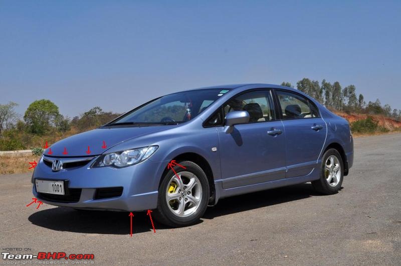

Originally Posted by dot (Post 2295201)
@sushrutha, do post pics when you can. Did you install a relay too?
Posting some pics..
I know the picture quality is bad as I used my mobile phone camera for same.
A pic of my car for the representation as where are all the screws n clips which have to be unscrewed/removed (only above the tyres, 2 screws, rest all are hooks/clamps
Honda Civic : Maintenance, Service Costs and Must dos-dsc_1214.jpg
Company provided holes. This is where I have put the clamps.
Honda Civic : Maintenance, Service Costs and Must dos-photo0031.jpg
Honda Civic : Maintenance, Service Costs and Must dos-photo0032.jpg
Honda Civic : Maintenance, Service Costs and Must dos-photo0033.jpg
Clamps added.
Honda Civic : Maintenance, Service Costs and Must dos-photo0035.jpg
Horns were correctly aligned after this.
Honda Civic : Maintenance, Service Costs and Must dos-photo0036.jpg
Horns were made sure that they don't touch any body parts when the horns vibrate after blowing the horn.

@sushrutha, Thanks for the pictures. Pretty much gives a complete idea on the installation. Hows the experience so far.
BTW, The yellow calipers looks fabulous on the Silver Blue color.
