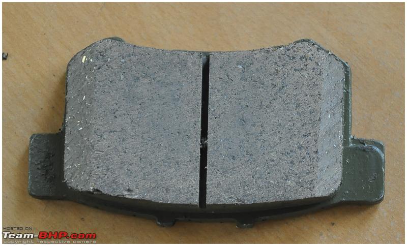

Originally Posted by laluks (Post 3335446)
Now that I have completed 3000KMs with the new pads, Initial 1000KMS in city driving and the rest 2000KM on highways, at some good speeds and related braking needs, with drives of 700+ KMs in a stretch, twice, the results can be shared. These conditions have taken the tests on the pads as required in almost all possible scenarios that the pads are supposed to work.
The results are positive, and I see no major differences between the OEM pads and the ones I experimented as on date.
But there are a few observations
1. During Installation, the pads locking edges had to be filed a little for easy sliding for the pads placement
2. The discs are slightly hotter than before, attribute that to the ceramic compound and more friction considering the OEM pads were metallic type.
3. The wear of the pads seems at this point similar to the OEM pads, but a lot of brake dust is generated pointing that the pads are wearing more in relation to the discs.

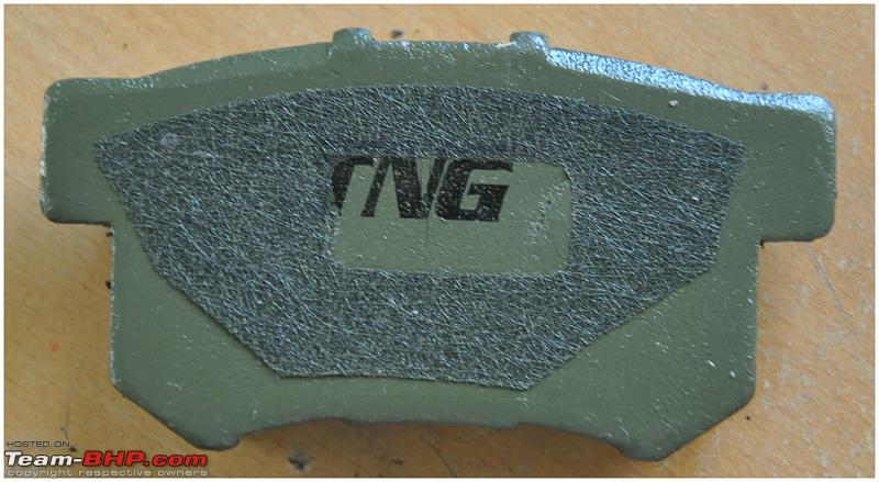

About the pads,
The pads were made by a company called TNG. Had read some reviews with mixed opinions before installation. So idea was to experiment in city before concluding that they could be used in high speed drives on the highways. The city experiments for 1000Kms over a span of 1 month gave me enough confidence to take it to highway drives.
The front pads MRP was Rs 1050, finally obtained for Rs 900.
Result - I am happy with the performance till now. The pad change was a complete DIY.

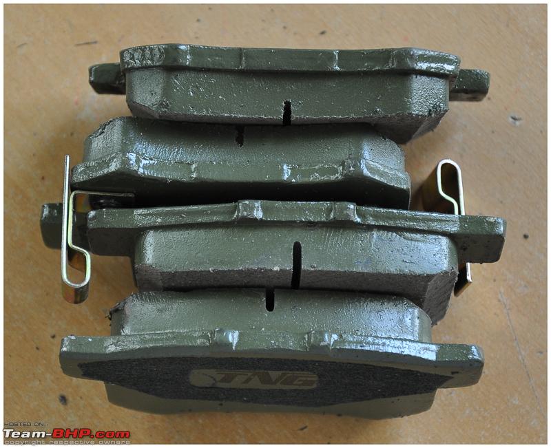

I changed the rear too with TNG today. The rear pads were a direct fit. No filing was necessary. Let us see how it fares. I will update the results.

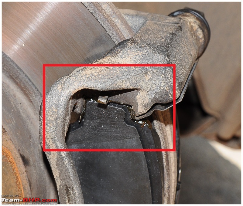

Completed 15K with TNG front pads.
There was a spirited run of 2500Kms thrown in which took a toll on my Yoko dbs.
Good for another 5K, just 15K done till date :Frustrati
Honda Civic : Maintenance, Service Costs and Must dos-dsc_0345edit.jpg

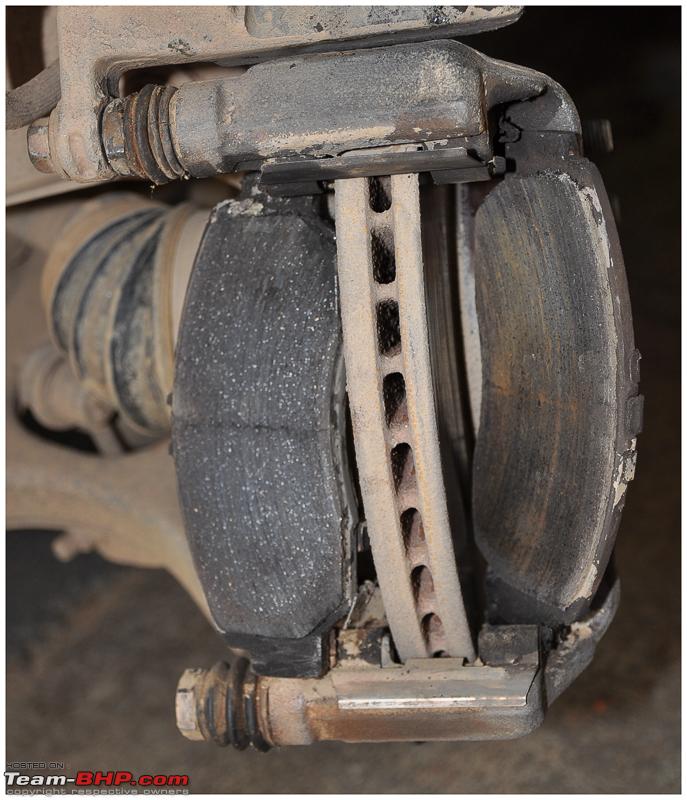

It seems it took a toll on the TNG front pads as well. Earlier going by the wear was expecting something like 30K, but the spirited drive has shaven of almost all of what was remaining :eek:!!
Today took some time to open the brake setup and check the pads.
New ones normally have some 11 mm of braking material, after wearing of 8mm it should be replaced
Honda Civic : Maintenance, Service Costs and Must dos-dsc_0338edit.jpg
Honda Civic : Maintenance, Service Costs and Must dos-dsc_0340edit.jpg

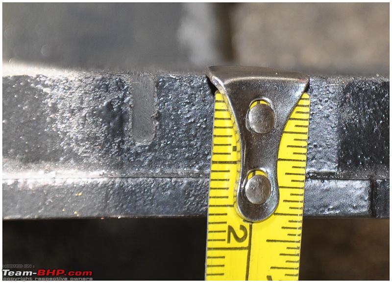

ON measuring TNG pads which have done 15K on date,
Front Right pads shows 3mm remaining
Honda Civic : Maintenance, Service Costs and Must dos-dsc_0397edit.jpg
Honda Civic : Maintenance, Service Costs and Must dos-dsc_0398edit.jpg
Front Left pads shows 2mm remaining
Honda Civic : Maintenance, Service Costs and Must dos-dsc_0399edit.jpg
Honda Civic : Maintenance, Service Costs and Must dos-dsc_0400edit.jpg
Comparison of 15K done TNG with new pads
Honda Civic : Maintenance, Service Costs and Must dos-dsc_0287edit.jpg
Honda Civic : Maintenance, Service Costs and Must dos-dsc_0289edit.jpg
Honda Civic : Maintenance, Service Costs and Must dos-dsc_0291edit.jpg
You can push these pads, on normal run may be another 1K, but decided to change them, why risk?
Observation:
1. No chipping of brake material
2. Wearing out seems to be very fast, more than expected on spirited runs.
3. If used only for regular city drives probably we can expect 20K
4. At a cost of 900 INR, TNG did its job pretty well, and a life of 15 to 20K is decent.
5. No surprise or panic situation in the entire duration of 15K.

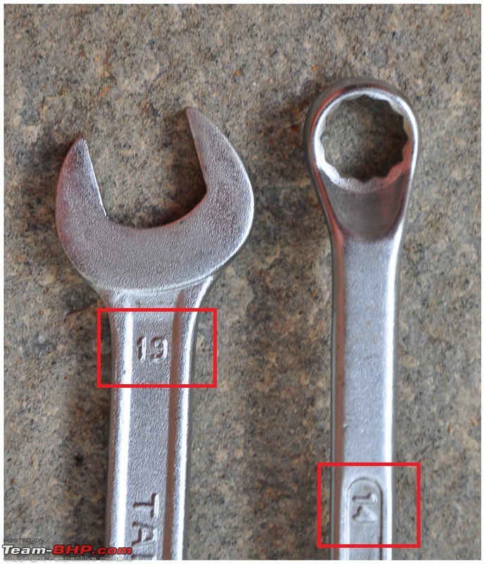

Check the size, 19 and 14

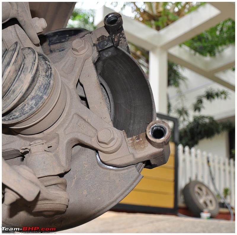

Remove the wheel and expose the brake assembly
Honda Civic : Maintenance, Service Costs and Must dos-dsc_0254edit.jpg
You'll have to open these, Use Ring Spanner outside while keeping Spanner inside to block them from rotating
Honda Civic : Maintenance, Service Costs and Must dos-dsc_0256edit.jpg
First open the bottom one and pull the cover upwards exposing the pads. Normally only this is required if you want to just clean the pads and put back.
Honda Civic : Maintenance, Service Costs and Must dos-dsc_0258edit.jpg
This is the guy which pushes the pads when you apply brakes! This guy comes out based on the wear of the pads to keep them nearer to the discs. In this case it has almost come out full.

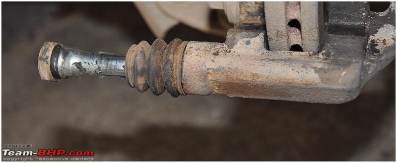

If you have seen some item in your service bill mentioning caliper pin greasing, then this is what happened :D
Pull out the caliper pins

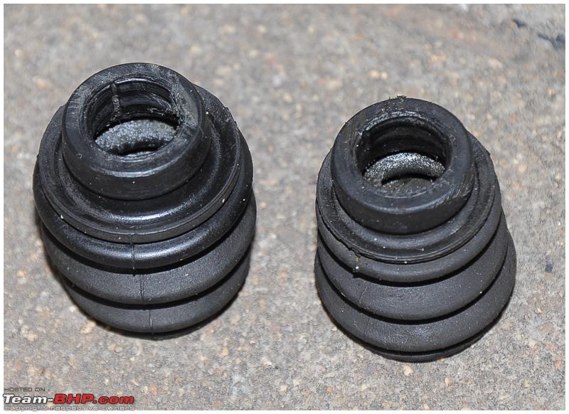

Clean the caliper pins with a cloth
Honda Civic : Maintenance, Service Costs and Must dos-dsc_0279edit.jpg
Clean the rubber bushes also

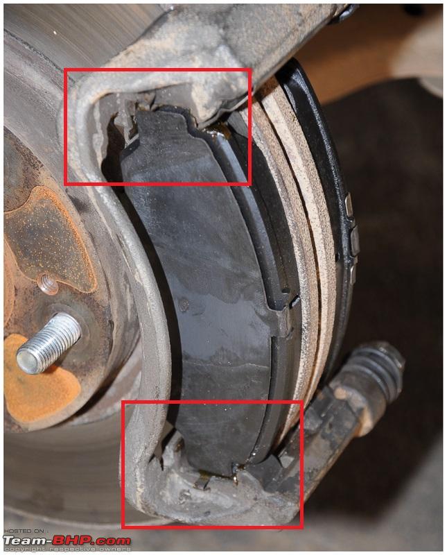

This is where the pads have to slide in
Honda Civic : Maintenance, Service Costs and Must dos-dsc_0371edit.jpg
Honda Civic : Maintenance, Service Costs and Must dos-dsc_0372edit.jpg
Honda Civic : Maintenance, Service Costs and Must dos-dsc_0374edit.jpg

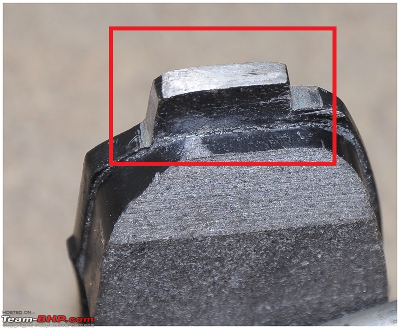

Sometimes these aftermarket pads wont fit in, Use the file to shave off a bit at the edges to get it in these
slots. Use a bit of molly grease for easy movement.
Honda Civic : Maintenance, Service Costs and Must dos-dsc_0375edit.jpg
After filing the pads nicely slots in

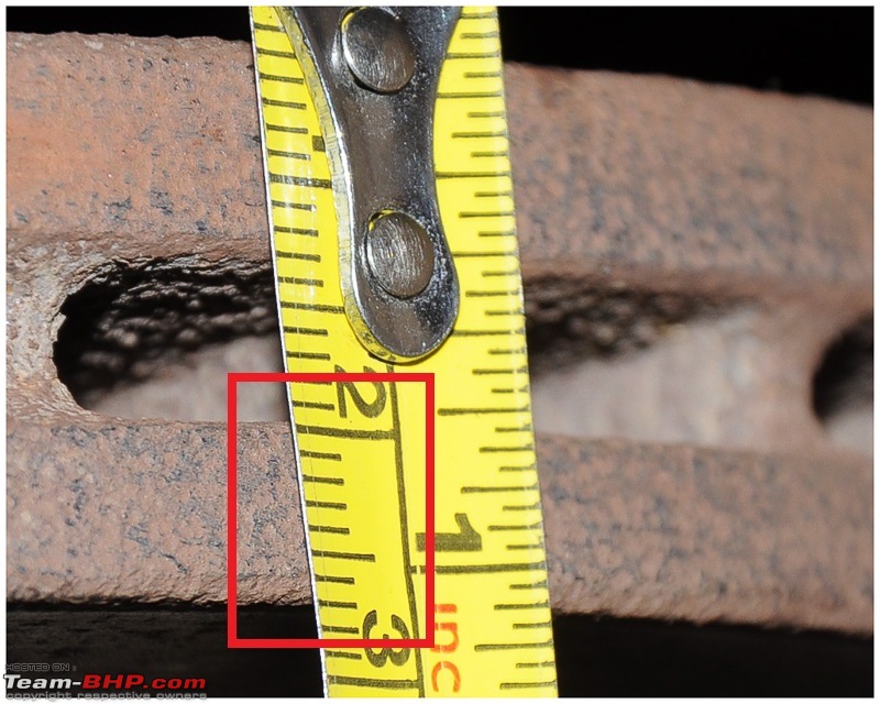

I also took this time to measure the thickness of the discs, seems good to go for some more time. The front rotors were changed some 65K Kms before. My next change would be a brembo rotor which gives a visual indication of wear.

Attached are the pics for the brake pads that I got changed with its box.
