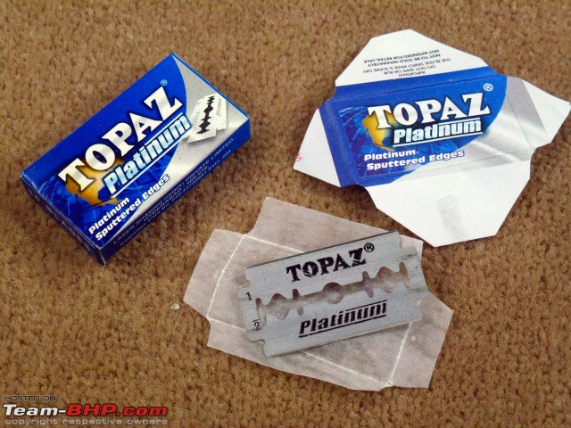

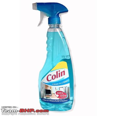

8) Excess hardened resin is scraped off using a Topaz blade. Any resin drops are removed using colin spray.

Colin Spray
