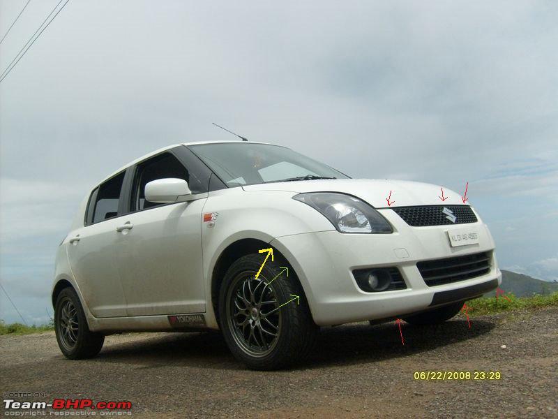

and removing the bumper will be kind of tough coz of hidden screws and locks. just be a bit careful taking it off.

Its not actually tough. I have marked the positions of all the screws, clips and bolts which hold the bumper to the body.
The screws are marked by yellow, clips by green and bolts by red.
once you remove all of them, un hook the bumper from the top and just pull it gently, and it will come off

thanks alot guys!!!!!
this really made it very easy.
