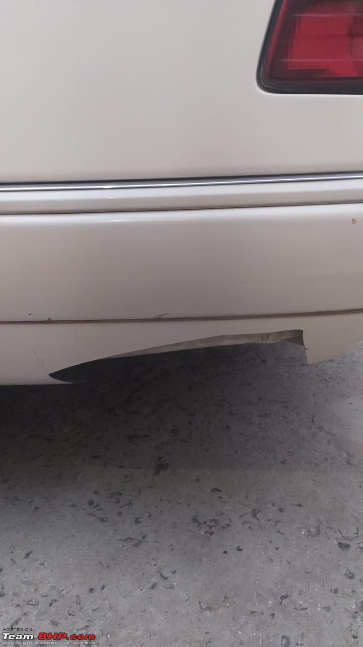

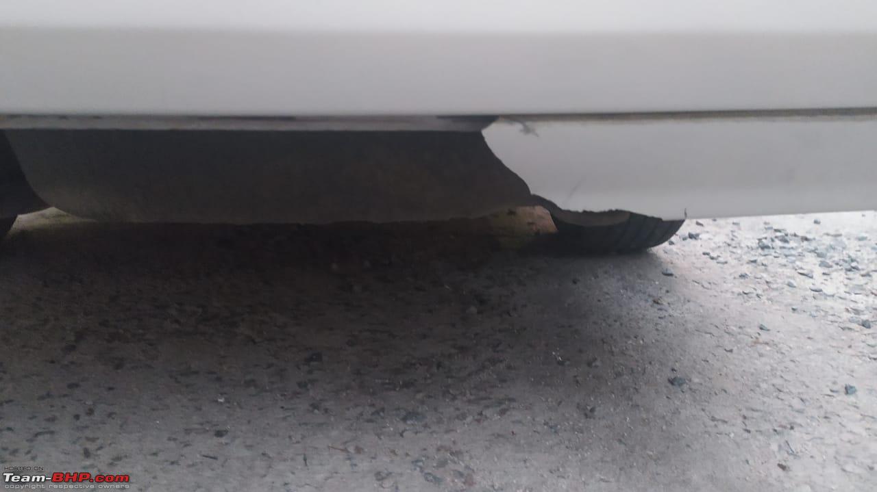

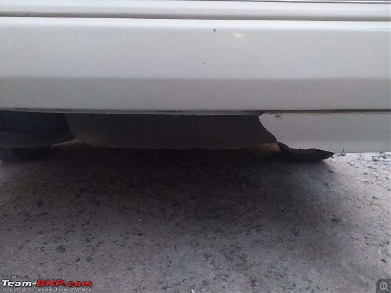

Have posted few pictures of the broken rear bumper.

That bumper is going to need replacing. Try contacting the shops at Palika Bhawan in Delhi (Sood Motors, Rahul Motors, Arihant Auto) if you're lucky, they may have a Taiwan made bumper available. It should cost around 8-10K plus shipping. These shops should also have the other service items you need. Once you've crossed newbie status, send me a PM with your number and I'll add you on a W124 WhatsApp group that will help with sourcing these items.

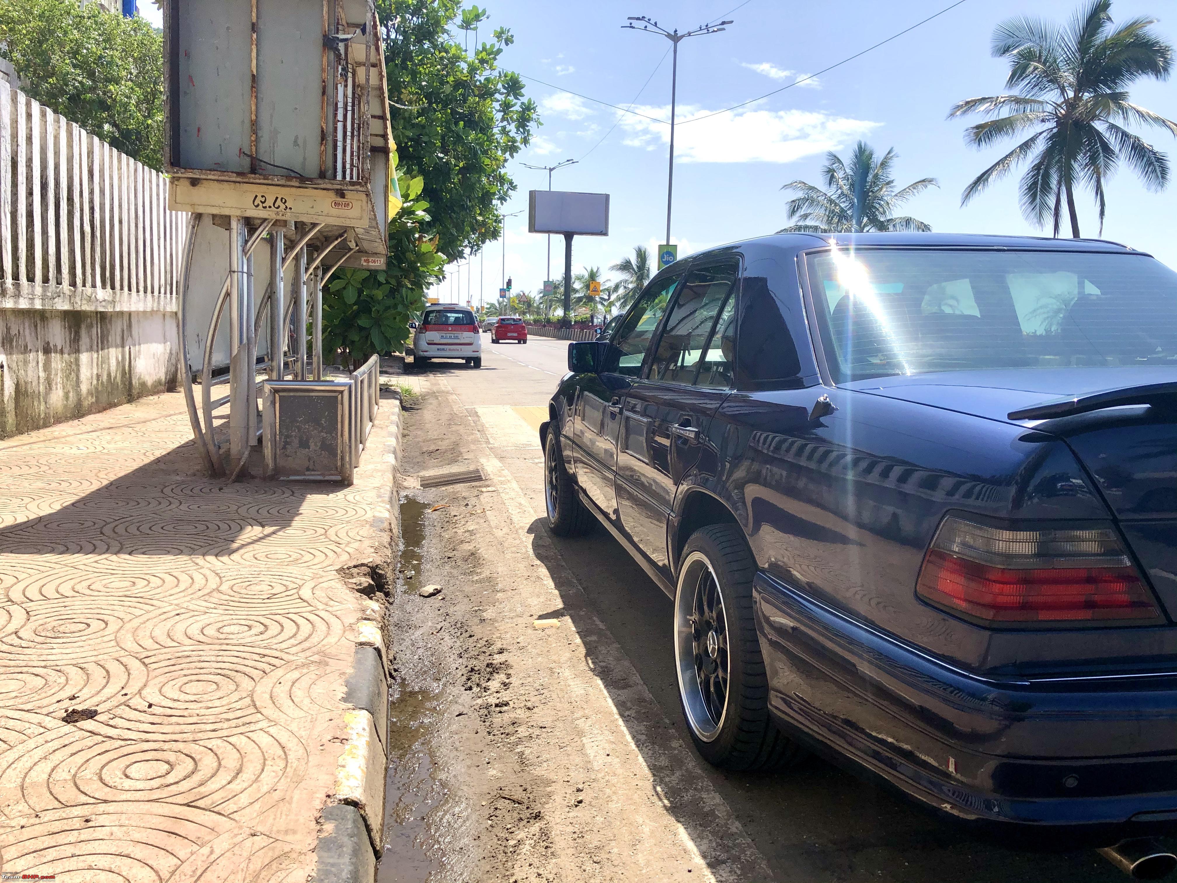

Hey friends just got her home !
