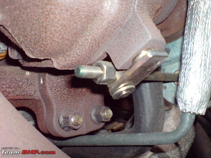

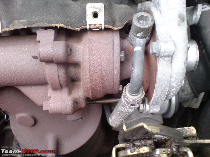

>> Yep it's done by adjusting the nut. Pics attached below. But as you said the fueling and the intake temps has to be taken care of for it to be effective and reliable.

Fiesta 1.4tdci turbo and waste gate nut.
