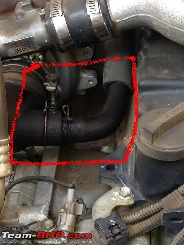

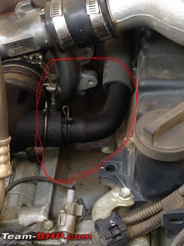

Old 27th February 2014, 19:17   #30
m-hawk's Avatar
Join Date: Feb 2008
Location: mumbai
Posts: 218
Thanked: 9 Times
Innova oil on breather pipe (I maybe wrong )
Hi all ,this is about my 2007 Aug model 97 thousand kms driven Innova G4 model.The car is regularly serviced with Toyota and has done Mumbai Goa few times plus is also a veteran of Mumbai Ladakh trip. The car was sent to Toyota for oil on breather pipe i assume it so because the pipe connects the turbo and air filter. Toyota performed a compression test and advice's engine rebuild as the compression is weak according to them. The engine starts with ease doesn't consume excessive oil so it beats me why should one go for an engine overhaul. Attaching a few pic s of the same problem highlighted with oil marks please advice .
