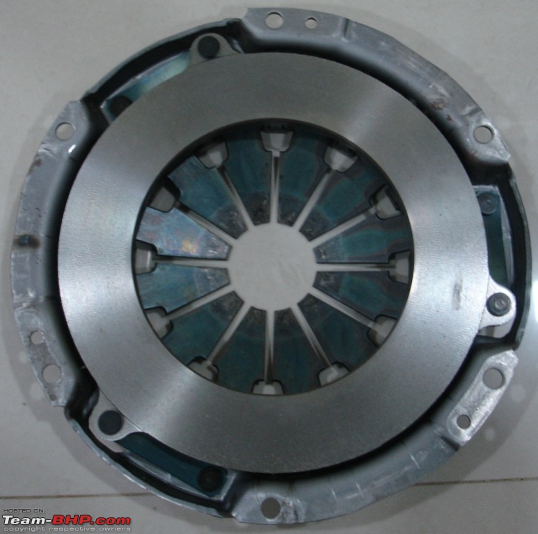

I recently changed the clutch Plate for my Honda City 2001 Vtech. I had a tough time sourcing the orginal parts in Chennai. Sundram Motors (Chennai) Quoted me 30k for the job I got it done for 12k. I changed the Gearbox oil to Castrol (Oil thickness 90), Changed radiator coolant and hose pipe, replaced front and back Engine beds, Phased the Fly wheel, Painted the brake calibers. All this costed under 12k including labour charges. Car feels reborn. Below are the Pics of Orginal clutch plate replaced with Excedy.
Exedy Clutch Plate and cover assembly along with NSK release bearing and SKF Flywheel Bearing costed Rs.5600. Exedy is Heavy Duty clutch, I feel the clutch is as same as the original. Notice the Spring on the plate of Exedy to that of the Original in the pics.
Dude, what are you saying. When i had enquired with Honda some 2 months ago, they gave me an estimate of 6,800 for a complete clutch replacement.

My OE clutch had lasted for 58,000kms. I have done a lot of mods and i always drive on the Higher RPM so it had to replaced this early.
Originally Posted by Shan2nu View Post
Dude, what r you saying. When i had enquired with Honda some 2 months ago, they gave me an estimate of 6,800 for a complete clutch replacement.
Shan2nu
Dude, that is just the replacement. Add labour charges, gear box oil, other repairs if any. I have known lot a fraud activities in the company. When they say they have changed u have to belive. There is lot of loop holes dude. I have burnt my finger earlier and seen it happen.

Its ok dude. Doesnt make any difference now. I love the clutch feel. Exedy i have used is a heavy duty one and the clutch slippage is much much lesser than the original. U see the thickness and length of the springs on the clutch plate, its much better.
