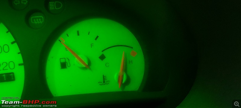

I know I am bumping an old thread
but today I found out that the High speed setting for the cooling fan is running slow. My Mechanic is diagnosing the problem as we speak.
He ruled out a Thermostat/Housing issue. So now after realizing the Fan running slow he thinks its the Relay/Resistor or the Actual fan motor too.
For reference, here's how high the temp guage goes in the attachment. Weirdly enough, it does this itermittently, sometimes it works well other times it overheats and there's no sign of coolant boiling and so on. Defintely not a blown head gasket because there are no signs of it (I.e White/Blue smoke, oil mixing with coolant etc)
Let me update here once I get the car back.
