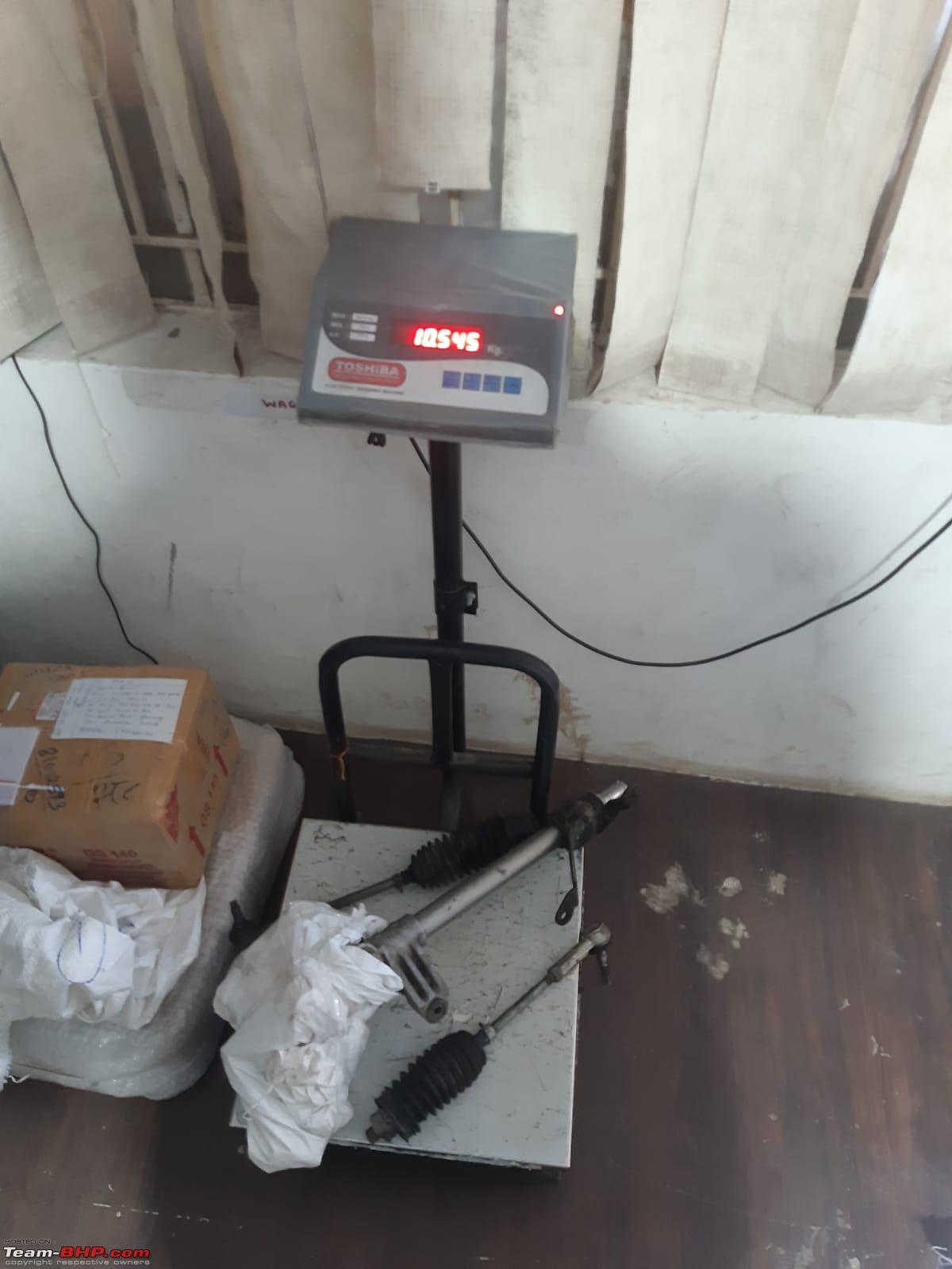

I bought a used rack from Pune, through one of the dealer's FB campaign. I had spoken to two trusted car advisors before ordering. Both said, Rs.7000 for a used rack is a good bet to give it a try. After seeing the photos and video of working condition of the part, I ordered it.

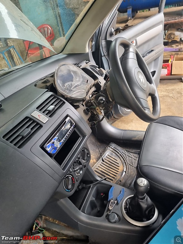

Once the new rack was fixed, the steering was still tight. It took a week to diagnose the problem. The doubts were shifting from speed sensor input to EPS to power supply to EPS.
Finally, it was the problem with the EPS module itself. They put an used EPS module at the cost of Rs.3500 (OEM around Rs.8000) and it worked. Drive shaft boot replaced for one side and drive shaft servicing was done. The steering works fine now and it feels breezy. There was a bend in the pinion of the rack due to which there is some hesitation in power assistance rendered at some particular points. Total cost for all parts + labour came around Rs.19,500. Feels, it is worthy given that I plan to keep the car for another 3 years.

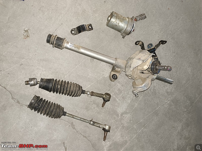

The old parts that are removed from car.
