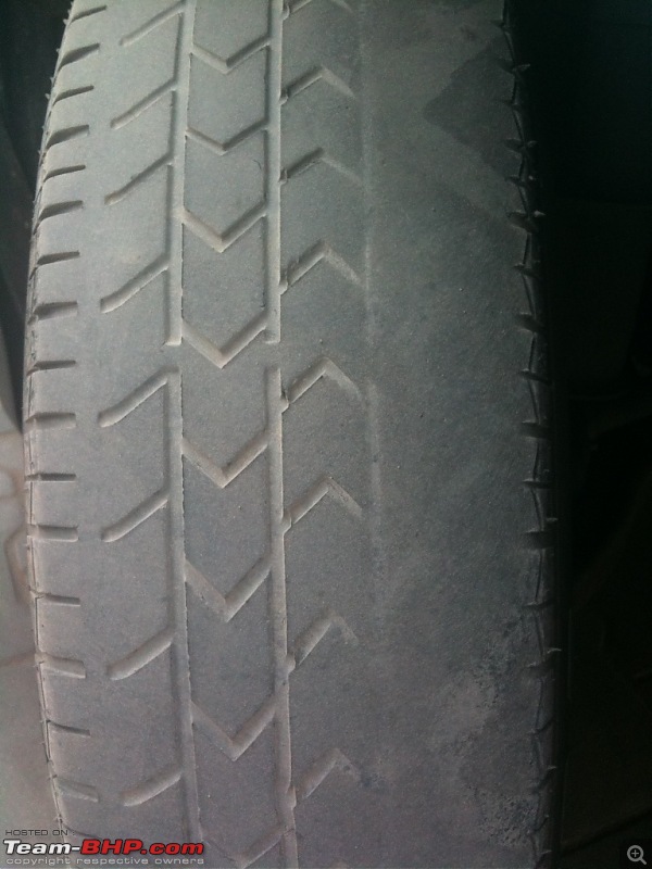

Hi ,
My swift vdi just crossed 22400 kms and suddenly i noticed excessive tyre wear since the 20000 kms paid service.
Havent seen this much wear prior to the 20000 kms when the wheel alignment, balancing etc where done by the service center.
What could be the reason for this? And now to stop this from happening even if I change the tyres. I see 22500 kms is too early for a tyre change even for an oem tyre (JK tyres)
Front left:

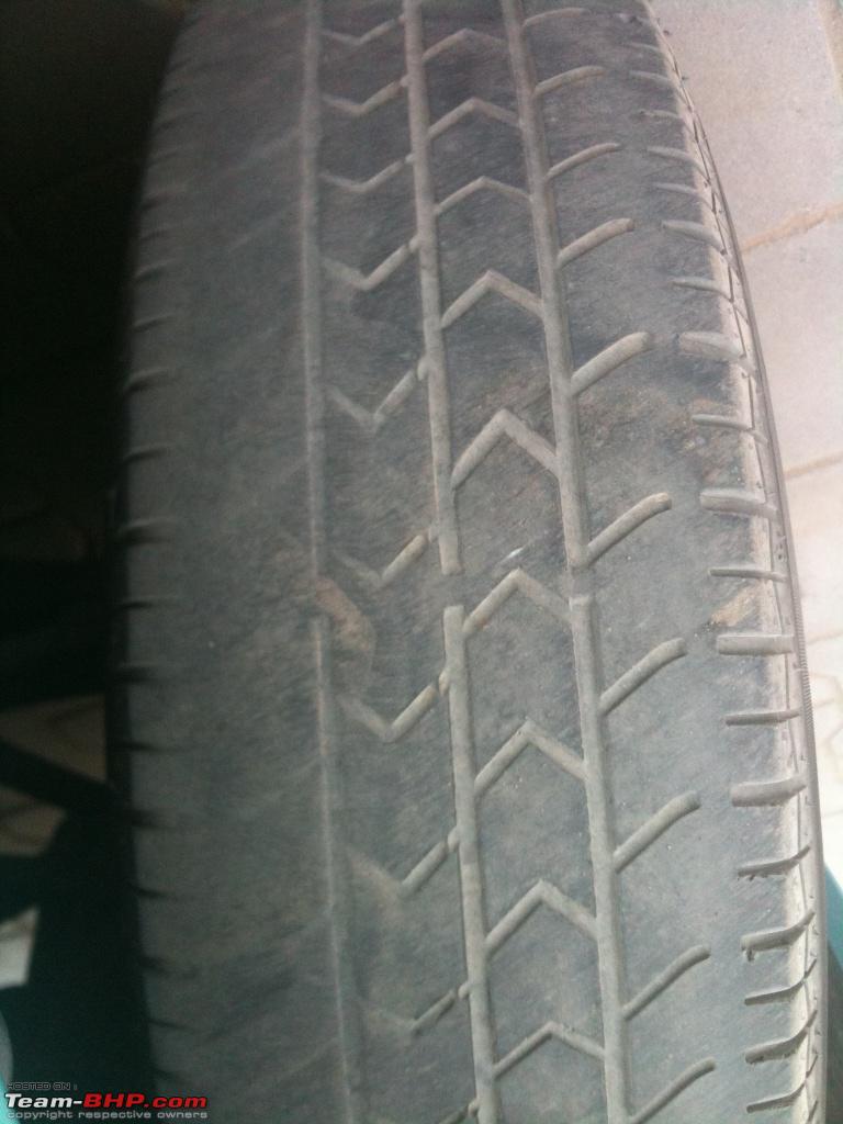

Front right:
Both seem to have wear pattern which is uniform and on the inside.
Looking at the pictures it is very clear that the wheel alignment has not been done properly. Or the tyres are not rotated regularly. this usually causes the wear the way you are facing. The inner thread of the tire gets worn out.

Tyre rotation done during every service / 5000 kms. But prior to 20000 kms the wear was even on all 4 tyres. This rapid wear is experienced only during the last 2500 kms.
ramkris a typical problem when wheel alignment isn't done correctly. If the alignment is out, it can cause excessive tire wear and steering or tracking problems. I would recommend that you get a new set of tires and get them aligned at a store who have state of the art equipment.
Ramkris
The wheel camber angle is on the negative side and out of range.
The normal range is +/- 0.30 degrees.
To confirm, just check the steering of another Swift with same wheel setup. Your car's steering would feel heavier.
Doesn't the wear look a bit on the higher side for it to be due to wheel balancing?
It might be due to play in wheel bearings and/or worn suspension joints too. Since this problem has appeared after the service, could it have to do something with the wheel bearing?

Is the camber adjustable on most front wheel drive cars? I thought only thing adjustable is the toe. That being the case, I narrow this down to either alignment issue with the last service/suspension issues. I dont remember hitting something heavily even potholes during the last few thousand kilometers. So without physical damage, suspension damage around 20k kms is quite unlikely. That too with uniform wear on the inside of both the front wheels.
I took the car to the service center couple of days back and toe was adjusted. But now I am feeling the car pullin g to the left excessively.
If I am going to change the tyres I would like to ensure this problem is resolved so that it wont affect the new tyres also. What can be done to ensure that this issue is fixed?
Even if the service center is to blame they wont bear the cost of the new tyres after 20000 kms of running right.
Unfortunately tyres have taken the toll, goto an independent alignment specialist and get the settings done asap and rotate so that front left can get some more kms. Use the spare instead of FT RT.
It's definitely a wheel alignment issue. No question about it.
