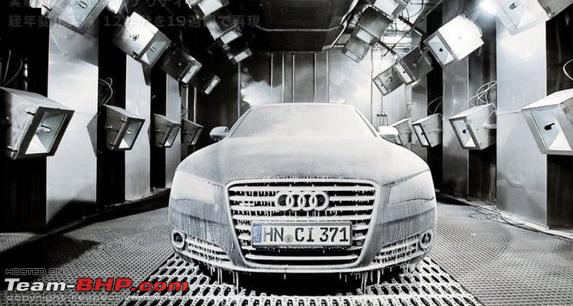

Testing is known under the label of the INCAS (Ingolstadt und Korrosion Altern) and has Audi in this way check around 100 cars.
The main goal of the test is the test of resistance to corrosion and ageing car bodywork. Car is located in conditions that simulate the "lifespan" of cars 0f 12 years.
The test takes place in several stages. The first stage is spraying the body salt solution and exposure of the cars in the climatic chamber with a constant temperature of 35 C degrees.
