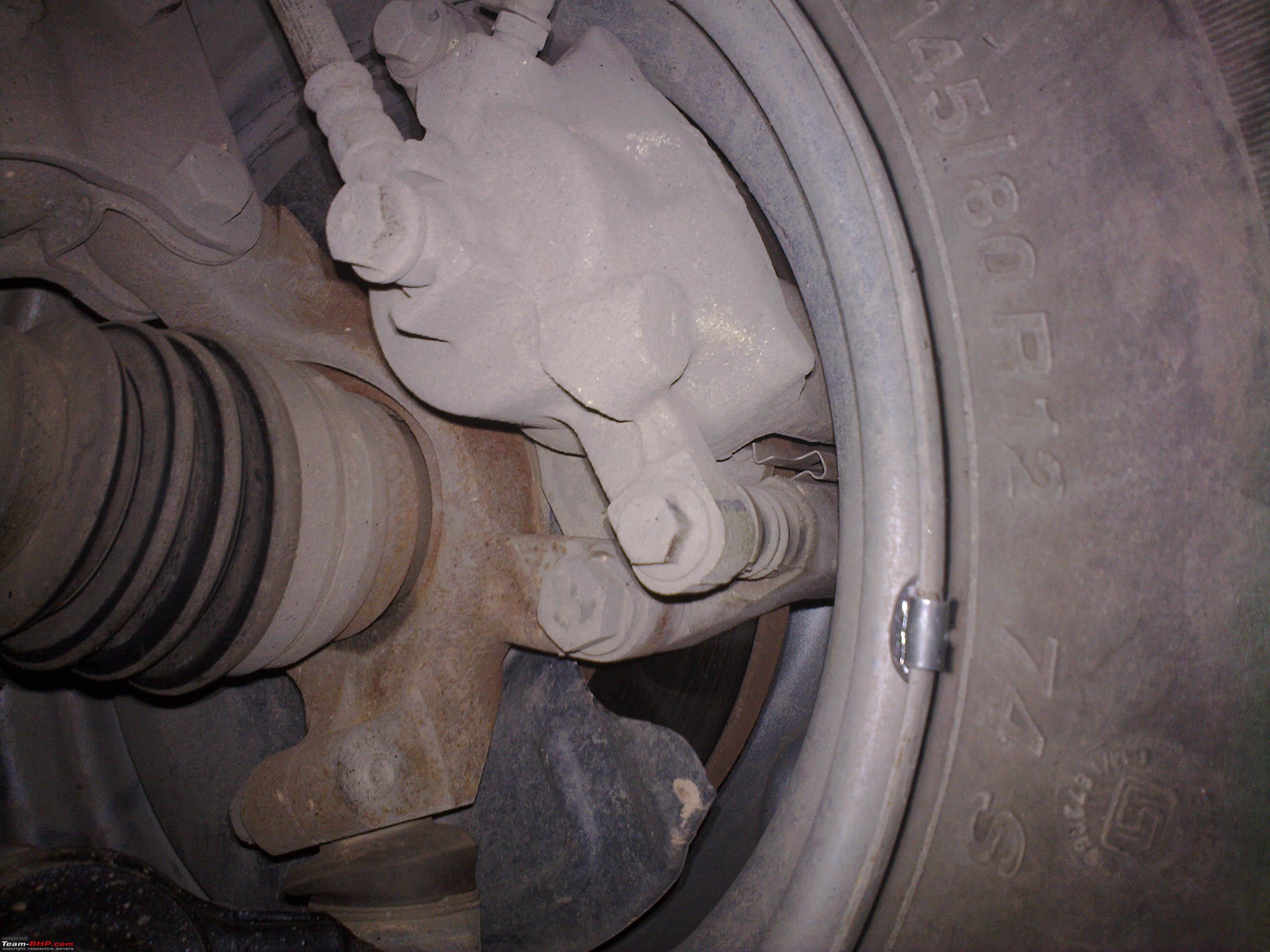

My Alto met with its first accident yesterday when the front wheels got into a ditch at night on a poorly lit road.
I have checked the underbody, but, no damage is apparent.The clutch has taken quite a beating while trying to reverse out of it & I suspect it has gone bad.Also, the front wheels are a little bit turned to the right, as it happened while negotiating a right turn & consequently, the car pulls to the right.
My question is, are any of the repairs which might arise from, covered under insurance?
I asked my local MASS and they said that I'd have to pay for the clutch, which will cost 5K, and is NOT under insurance.

I recall there was an amply loud rubbing sound while reversing, which I initially thought as spinning wheels, and the smell of rubber was due to the wheel fouling with the boundary of the ditch. But, as I now know, neither front tyre is 'eaten', and the rubber burning was my clutch.
It also isn't slipping per se, I checked top speed in 1st gear and it coincides with 41.5 kmph (mentioned in manual) and that is where the rev limiter cuts in. Also, the engine stalls immediately on doing the clutch test.
What's happened is, that the car is a lot easier to stall in first gear and the clutching action is not uniform, so, it could be uneven wear.

The clutch indeed has worn, but not enough to warrant a replacement, given my low running. Wheel alignment & balancing was done. Total bill for repairs amounted to 4K. I paid 1K odd from my pocket & rest was through insurance.
Goodbye NCB!
here are the pics.
