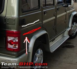

hi guys i want to buy 3m double sided tape in pune.
dose any one know where i can buy original 3m scotch double sided tape?
i want it for DIY repair of bolero body-cladding.

Try any one of the numerous stationery / packing material shops in Ravivar Peth or Bohri Alee (lane). Another place you could try is Carax Auto Accessories store (http://www.carax.in/) - they are authorized dealers for 3M products.

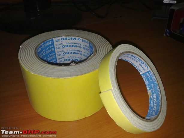

well i have normal double sided tape but its not good enough for body cladding.
that's why t want 3m's scotch brand tape.
the accessories shop charge 200 for sticking single piece of cladding . (its around 2 ft)
i think the full tape it self costs around 300 bucks, tight?

If you want only 3M Ask for VHB 4956(0.5mm thick ) or 4922(1mm), both are available from 6 mm to 25 mm in width, for your usage 8 mm is sufficient, for proper bonding u have to buy scotch VHB primer, you can try with a Aluminium structural glazing contractors are Glass dealers,

@Viji, why is the primer required ? And will affect / damage the paint when you are taking it off ?

Primer gives extra adhesive power to the tape. and it is not a paint primer its a special chemicle they call it as primer. paint part i don't know because we use this to stick glass to aluminium sections and all our sections are anodized and we normally avoid sticking the glass to painted surface.
