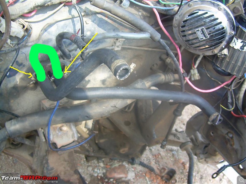

Thanks for clarifying. I meant something like this as a quickfix to drive the car to the service station
even if you leave it open, it will do no harm to your car. You will have to block the main pipe (radiator) that goes into this.
I think the OP's mechanic did the same thing.
But 1200 is still expensive. You just need to open the radiator elbows and wield it shut. Even if aluminium wielding with job with a MIG weilder is considered 1200 is too high. Its a Rs. 400/- job considering the fact you have to remove the coolant and refill it again, a messy job.

I am having a similar problem with my Wagon R (CNG).
The heating coil is kaput and I have bypassed the system as shown in post #16 by Just cause.
Yet, I am having some coolant seeping into the carpets.
Went to the person who did the work and he said that it will not be possible as there is a bypass and coolant should not seep in.
He further said that it may be due to my recent car servicing at MASS which could result in slightly wet carpets and the earlier mixed coolant is showing up.
He tried to suck in whatever remaining coolant was there in the pipeline(nothing came out though) and used Nitrogen gas to clean up.
He suggested I use newspaper to soak up the residual moisture.
Yet, yesterday, I could see some fresh coolant seeping in.
What is happening and why?
Any simple fix to this that would not require me to run to the garage?
I fail to understand if the pipe has been bypassed, then why is the seeping still there?
Pls. help.
